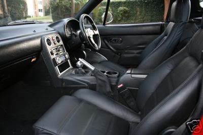

I hope this has worked, I get the covers tomorrow and this is the photo of them, will post some more when i’ve fitted them.
