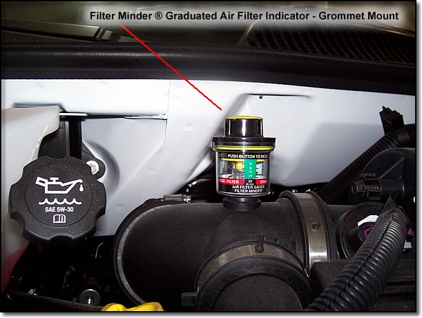

Filter life is less determined by mileage, but by environmental conditions, and filter changing should be determined by the extent of clogging. Hence air filter indicators are becoming preferred;
