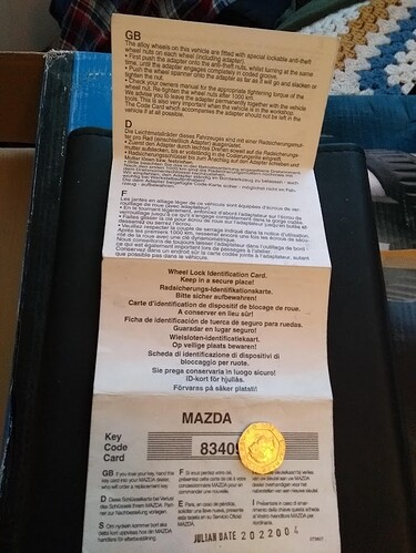

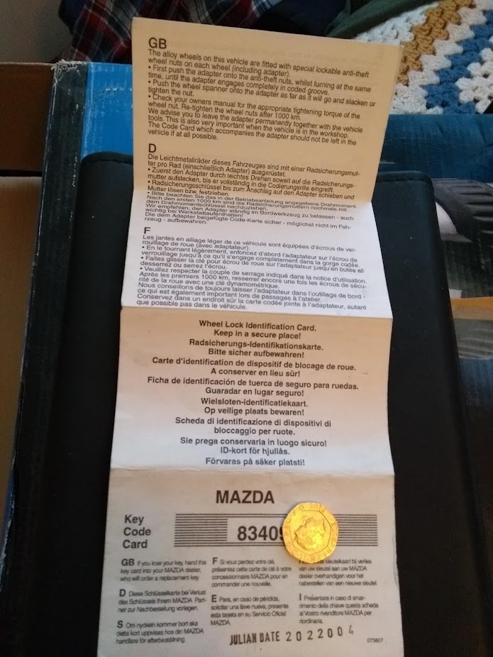

I found this card when I got my car. Is the number for a key or the wheel nut adapter? I could really do with a spare key. Also, my 2.5 Sport only came with a key, no fob, is that right? It has two horns fitted and one had been disconnected. When I tried reconnecting it, the alarm kept going off randomly and when I was opening the door.
TIA, Drewski.
That’s for the locking wheel nut key.
