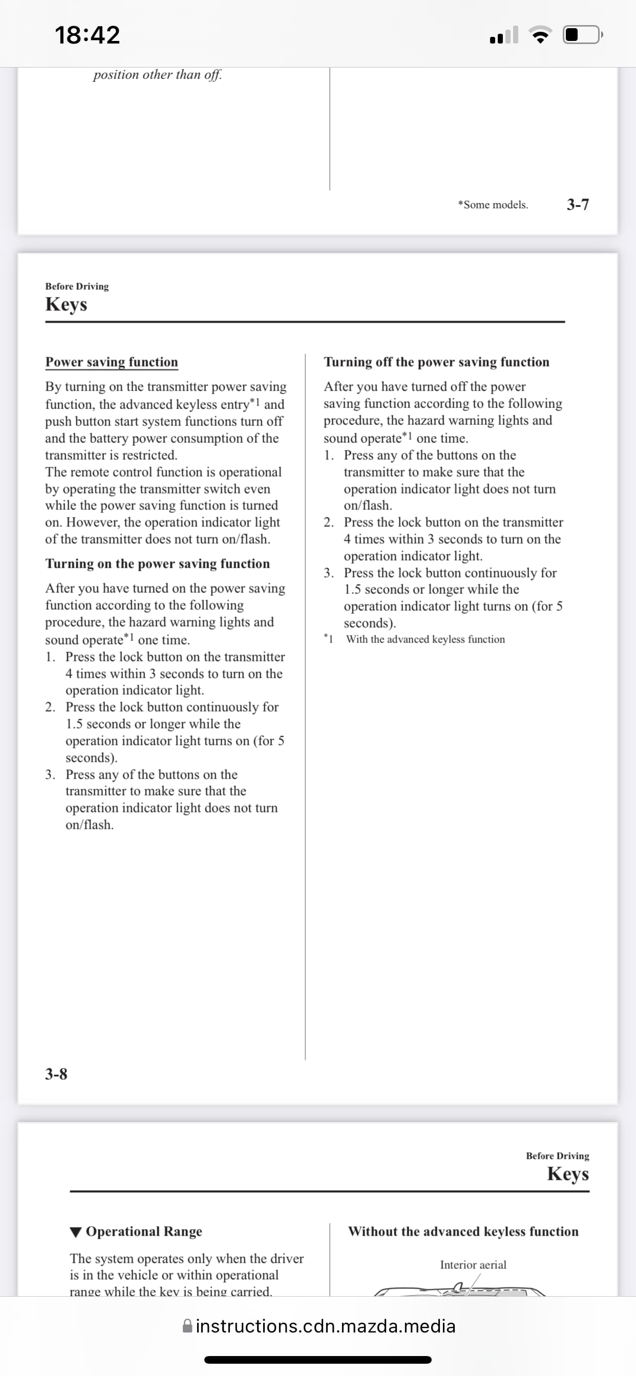

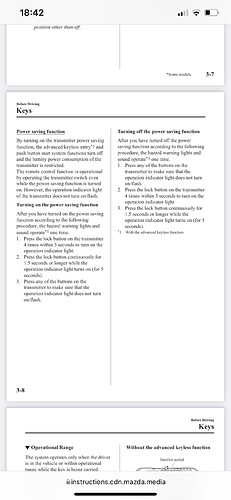

How old is the car? You say “new”, new to you or brand new? Later keys have a power saving mode that deactivates the start button function. Do you have the black rectangle key or the tic tac shaped key?
Brand spanking new - 22 plate delivered yesterday. I think the key has an issue - new battery put in by me and same problem - had to hold it up to the start button to make it work. I’ll get them to look at it when it goes in for a service. I don’t need to second key really.
I have the flat key with the buttons down the edge. I think the energy saving function may only be for the advanced keyless, which I do not have.
Have you tried the procedure to turn it off? The power saving function is a function of the key not the car.
