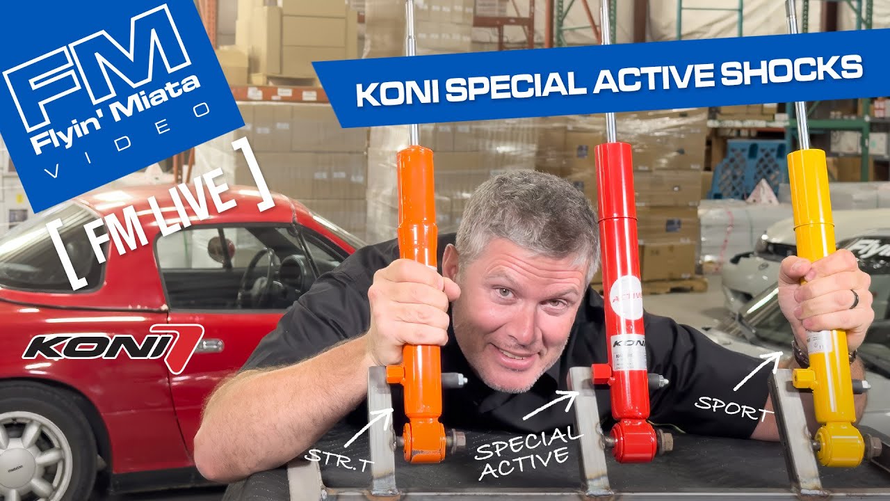

I’m interested in these dampers for my car. Has anyone found them in the UK? According to the video I’ve flagged they are only just appearing in-the US for my NC but have been available for the NA/NB for a while.
The problem I foresee is they are recommended with standard, not lowered springs. The Nc1 is silly high so I don’t want to refit those. The 30mm lowered springs I have fitted make the car look like a standard NC2> so logically I should be able to use these springs with the Special Active dampers? But the lowering springs were sold as fitting all NCs even though the car got lowered when the NC1 was superseded.
My other concern is I’ve installed RX8 yellow spot ARBars which I really like. The SP dampers are mostly activated by time: ie in a corner they react to the roll of the car(which is a relatively slow event in suspension terms) so I may not reap their potential benefits here?
Hope you are not as confused as me :slight_smile:

Yes, that’s the conclusion in the Flying a miata video too. Still don’t seem to be availiable in the Uk. I don’t want the sports Koni for the same reason I don’t want coil-overs: too harsh for what I hope will be a touring car in the future.
