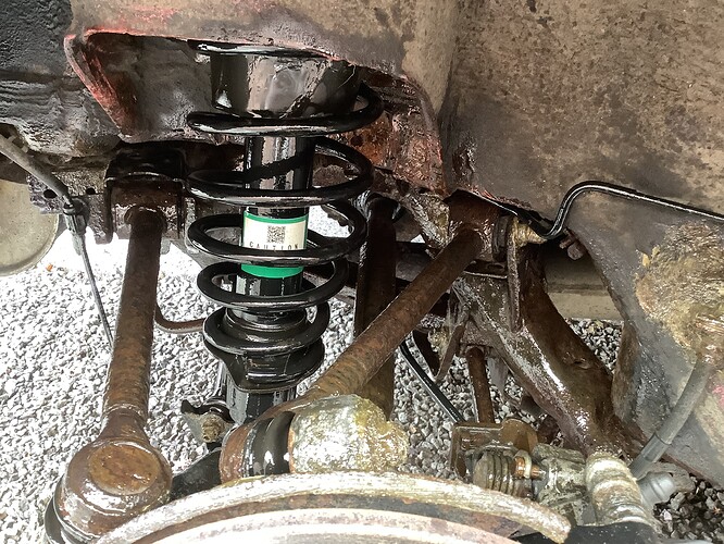

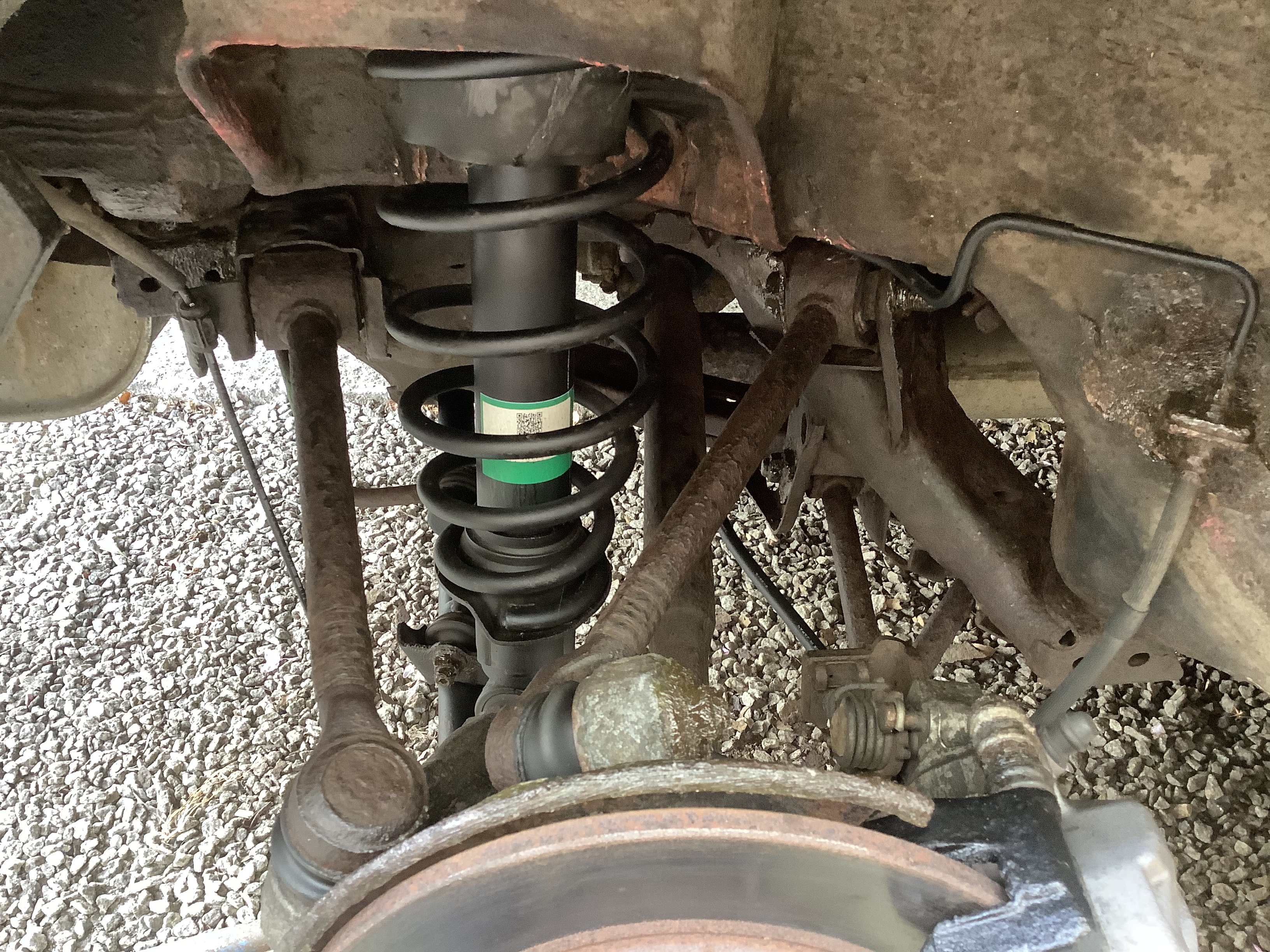

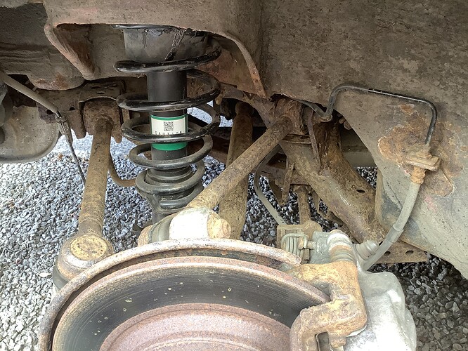

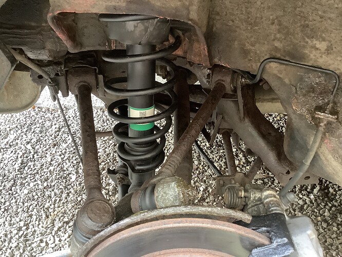

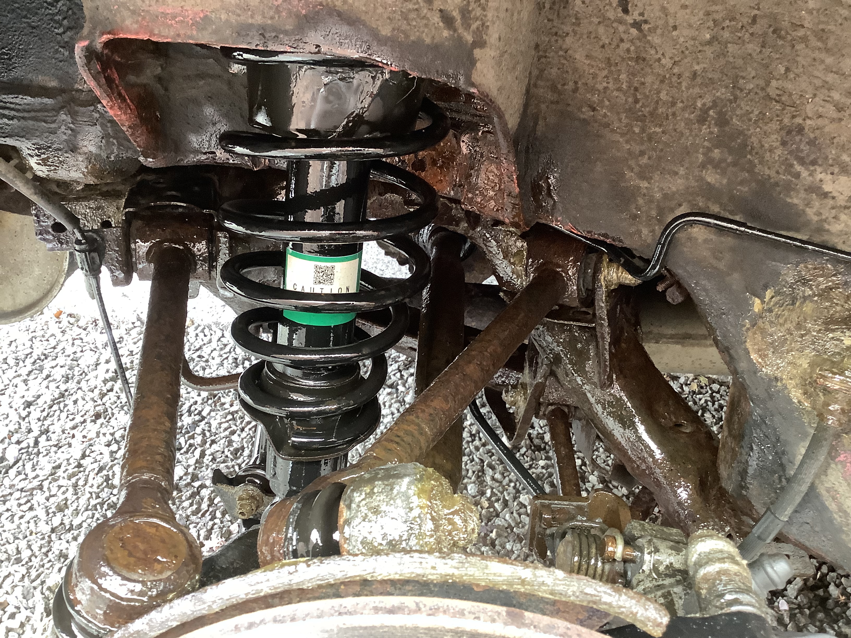

I started by jacking and putting an axel stand at front offside, removing the wheel, completing the work, putting the wheel back then moving on to the rear offside then onto the near side.
Each corner took at least 2 hours to scrape back the rust, another 10 minutes or so greasing nuts, bolts, seams and vulnerable areas then just a couple of minutes with the Lanoguard spray.
Then I moved on to the underside, not really a lot to do there fortunately but I have to say I am really happy with the results, time will tell so took a number of photos to compare when I next come to top up next year which should hopefully be a doddle and will only take 20 minutes (we will see)!
I didn’t bother about rust treatment, the car is a summer runabout and is covered and under cover in winter with plenty of ventilation so didn’t see the need.
The only issue I had was that the spray head stopped spraying after a long session, it was down to a blocked filter at the end of the pipe in the container, easy sorted, pull off, run under warm water, clean off, wouldn’t recommend leaving the filter off as the spray nozzle would then likely block and be more difficult to clear.
Another tip would be to put the grease container in some warm water before use, makes it easier to remove and brush on.
Here are several pics showing before (after cleaning), during (after grease & spray) and after (24hrs later) -
