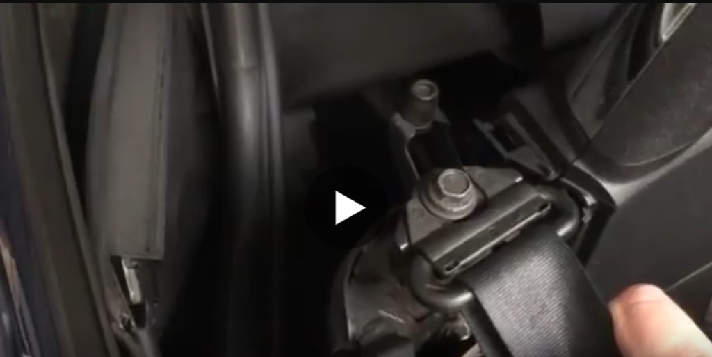

Lazy seat belt modification
I think I know what a lot of us will be tryign in the next few days/weekends - Many Thanks Dickie Dover :wink:
Ā Spot on mate both belts fly back now.
Anyone wishing to shave a mm from the plastic guide, but scared to put a stanley blade anywhere near the seatbelt.
The plastic guide will unclip.
Ā
Along the front edge where we can see the 2 x rectangular holes, insert a flat blade screwdriver under the plastic (bewteen the plastic and metal hoop) and twist.
Do both sides.
When the front edge has popped out, slide the plastic guide rearwards to free from the rear tabs.
Refitting is the opposite.
Great thanks for the video, mine is painfully slow and need to do this mod asap

I’m trying to do the seat bed mod but the photo in the first post is no longer showing and I’m unsure which bit I’m supposed to cut away.

Just watch the Facebook video on the postĀ  lower down shows clearly which parts

With the MOT coming up and the seat belt getting slower to retract I have finally got around to trying to improve matters. Firstly tried cleaning the belt with soapy water, a slight but not a major improvement.
Then remembered this post and set about removing the body trim covering the seat belt hoop and hitting the hoop down at each corner with a hammer and block of wood. Success and after a quick spray of the belt and hoop slot with Autoglym Vinyl and Rubber Cleaner the belt fully retracts easily.

I too cannot see the video and am slightly confused at what part to cut or modify :+1::+1:
this worked this morning…
https://www.facebook.com/richard.dover.73/videos/1564664230237361/
I must be being thick here. I’m still unsure Exactly where to trim.
I can’t get sound on the video which isn’t helping.
I see the fella removing the plastic moulding and pointing but then demonstrated how well the belt moves so I’m assuming he’s already cut something away ?

The sound is muted by default. Put your mouse over the video and you will see the speaker symbol with a x next to it. You need to unmute it.
I’ve tried without success to work out exactly the part I need to cut or remove, I can see in the video the person pointing at what appears to be the already modified area.
Sorry for being thick here but I’m just not getting it. I would rather appear thick than destroy something.
So if anyone can indicate exactly what I should be cutting trimming or removing I would be grateful.
