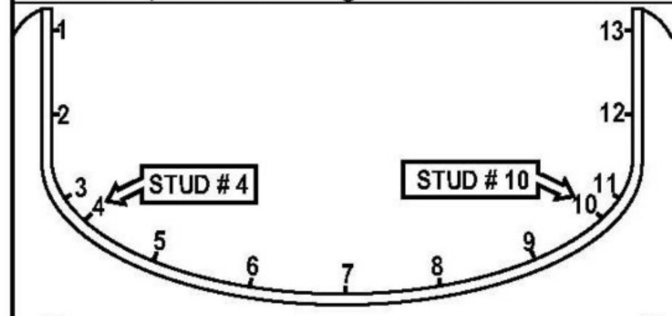

If a fitter put in the roof, they might not have tightened the spreader bars correctly. There is a sequence, so might be worth loosening and retightening in sequence (but note the torque).
https://www.miata.net/garage/rainrail.html

Okay so during the summer I replaced the soft top due to a crack in the rear window and should have replaced the rain rail at the same time. On inspection the rain rail had a hairline crack between stud 9 and 10. Before this I have had no issues with leaks from the rain rail, despite not fastening the rain rail bolts to spec (although I have followed the pattern).
So I ordered a new rain rail from moss (the robbins rain rail) and installed it and still water is getting through onto the parcel shelf and into the boot seemly through stud 9.
The holes on the metal retainer are bent toward the rain rail, likely as a result of overtighening which is perhaps the reason for the leak.

If the stud was so over tightened that the bar was distorted, maybe take everything off, and take a look at that stud. Maybe something needs tapping back.
