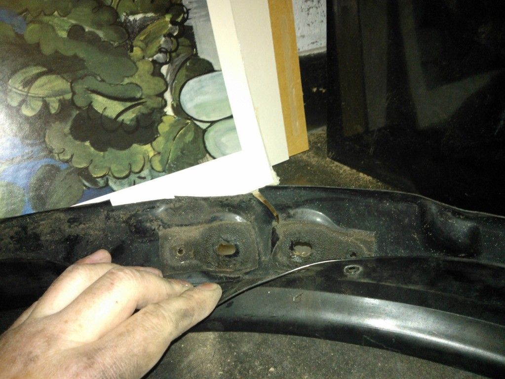

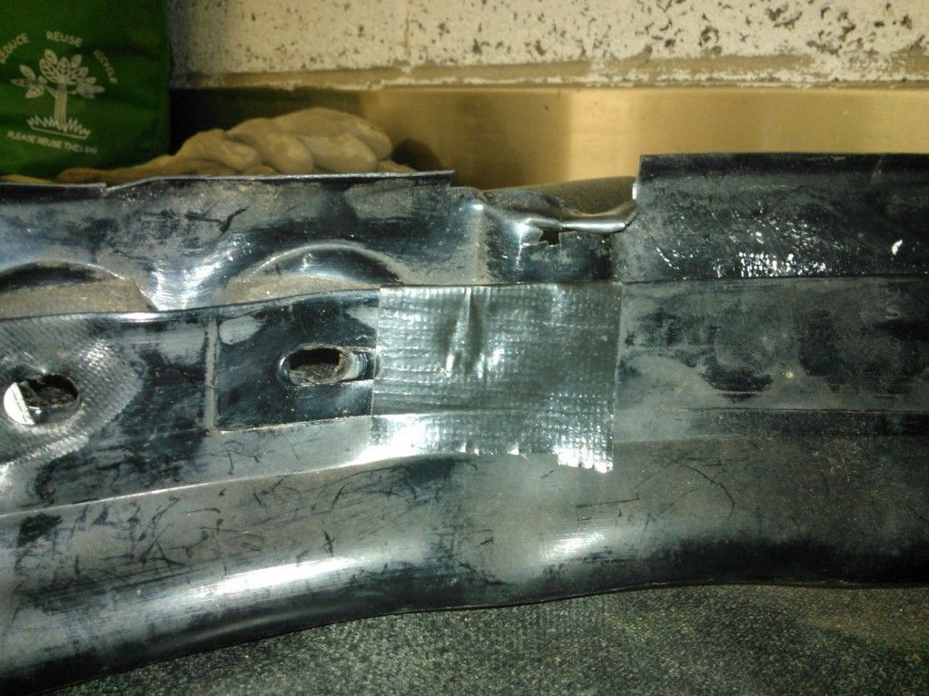

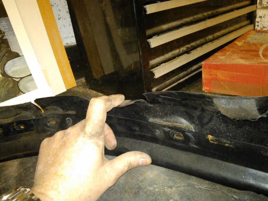

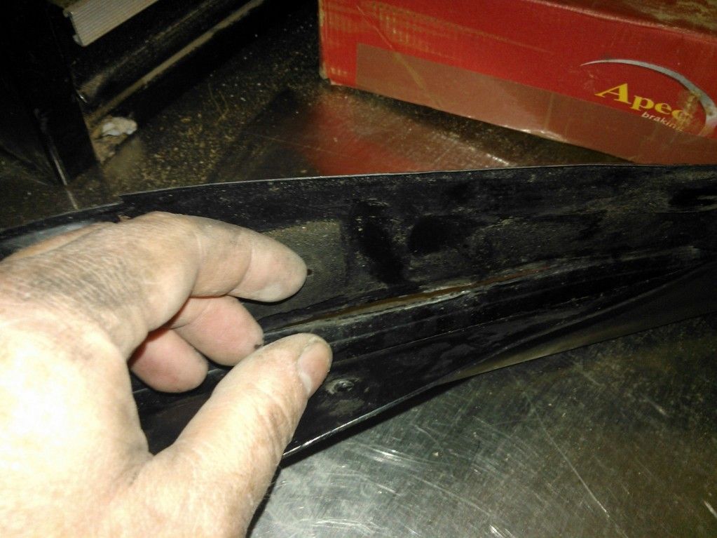

Managed to get the rain rail out once i got the rivits drilled out.
It is in quite bad shape as you can see in photos.
Will clean it up tomorrow evening and see about patching it together.
Think some of the splits is from me getting it out. funny thing is were i seen the leak looks ok.
Take it was running round before running off.
 Get some silver alloy tape to patch/seal it back up,but you most make sure it is clean and dry so the tape will stick.
M-m
