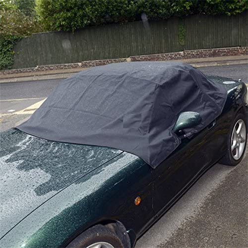

Sounds like you could do with a half cover, one that covers the hood. It’ll protect it from the elements and that tree.:+1:

On the cover point I don’t want a full one, I’m told they can cause too much condensation and further problems. One like this though will stop the pine needles and leaves getting into the spaces around the scuttle and wipers image
