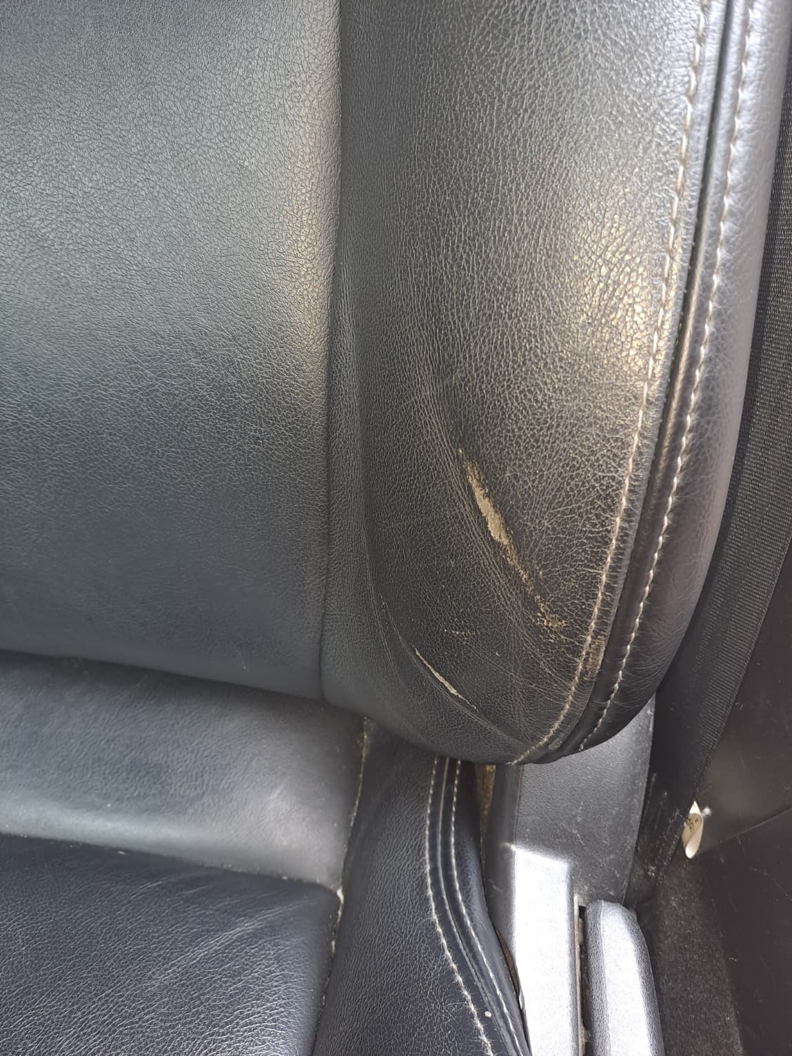

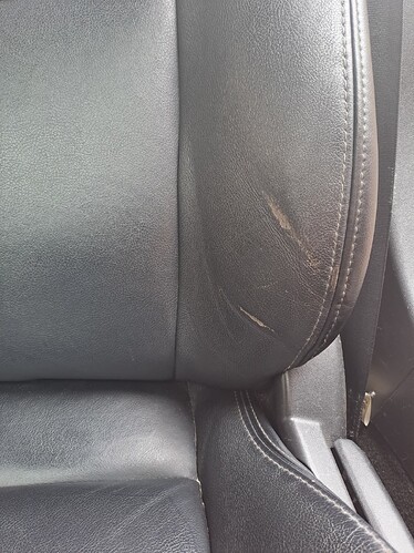

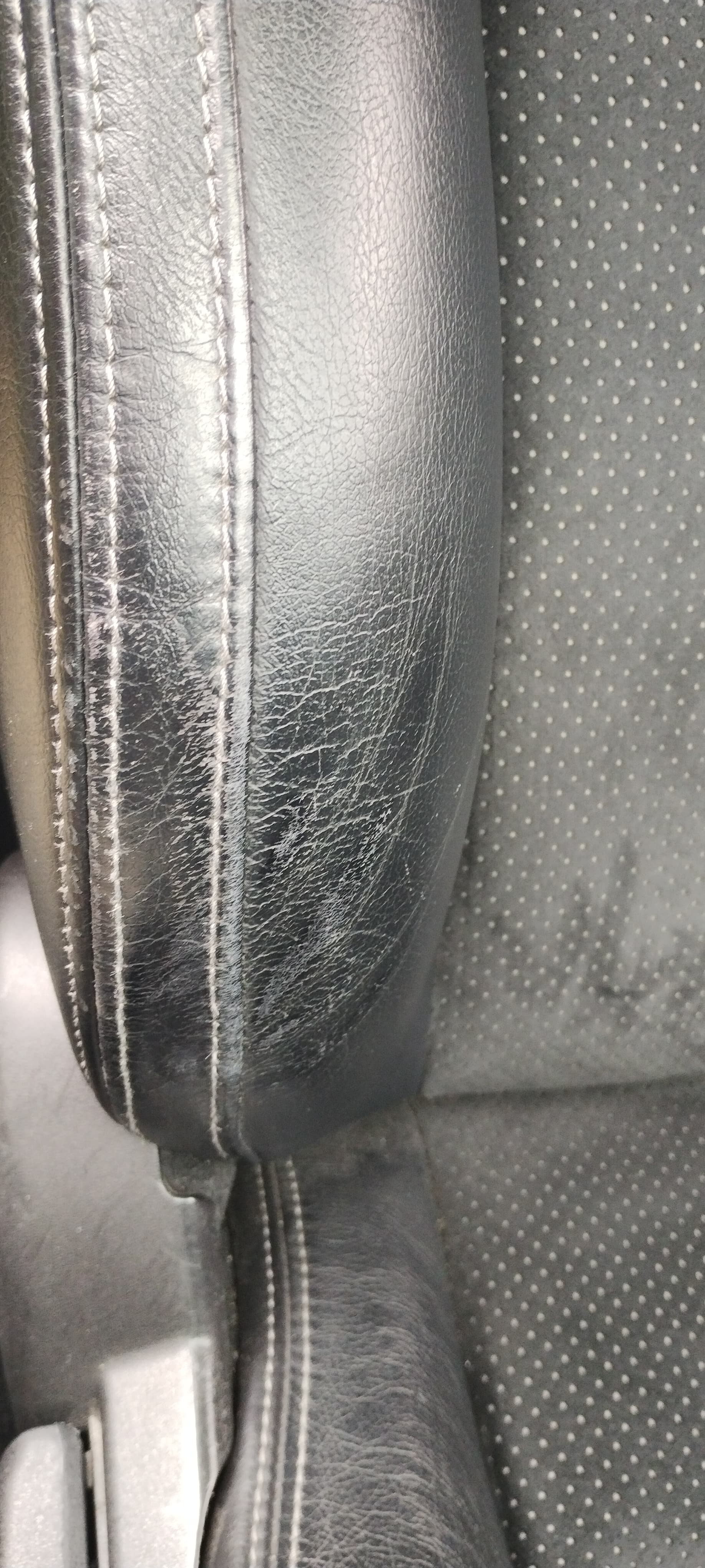

Hi, just wondering; would it be possible to “restore” a part (bolster) of the leather seats of my 2010 NC leather seats with a (which?) product with a good result (and without colour difference)? Or should i have it restored by a proffessional? The seats are in good condition and i like to keep them as they are.
Beside this i would like to brighten up the stitch with a white textile maker, any expieriences?
Try black shoe polish first.
I had some red leather seats and tried a red colour leather balm on them. It did cover up for a while but wore off and needed reapplying on a regular basis.
I now have black leather seats and just apply a light rub over with shoe polish now and again.
Did similar with a worn leather gear knob, a good clean and applied shoe polish. It looked a little rough at first but now with use you can’t tell where the worn parts are.:+1:
I have used this stuff on a black leather sofa with good success.
Thx guys, Mick; interesting and extremely cheap, altough i couldn’t find any similar expieriences on the net i might give it a try, no shoeshine sticking on clothes?
Cbrdeano; that product gets very good revieuws indeed, point is …in Belgium and the Netherlands it’s unavailable by now (the black one, others are) and buying from UK is a bit to “challenging” these days (Brexit…) . I found another product (Angelus) which gets also very good revieuws. I might give the shoeshine a try …on the back of the seat first and will then judge what to do. THX :wink:

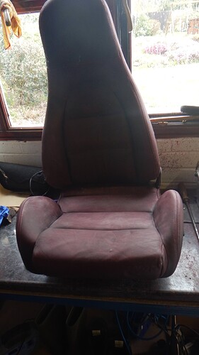

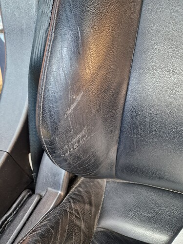

The driver’s seat on my 07 Mk3 daily looked like this 3 hours ago.
And now looks like this. A bit better but now I know how to do it, I think I can do better. Can’t polish it for a week.

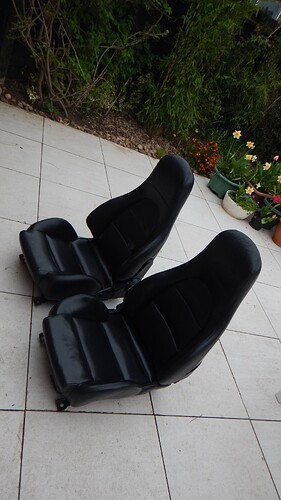

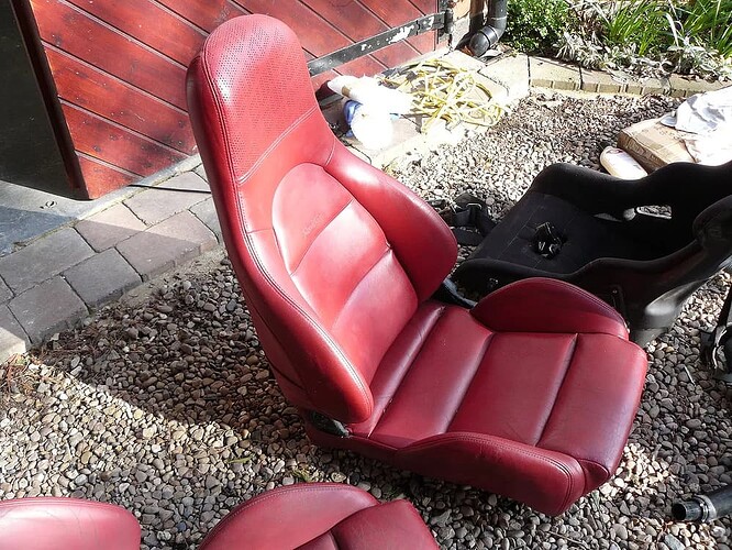

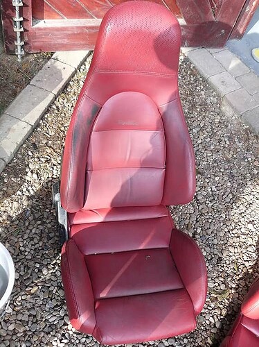

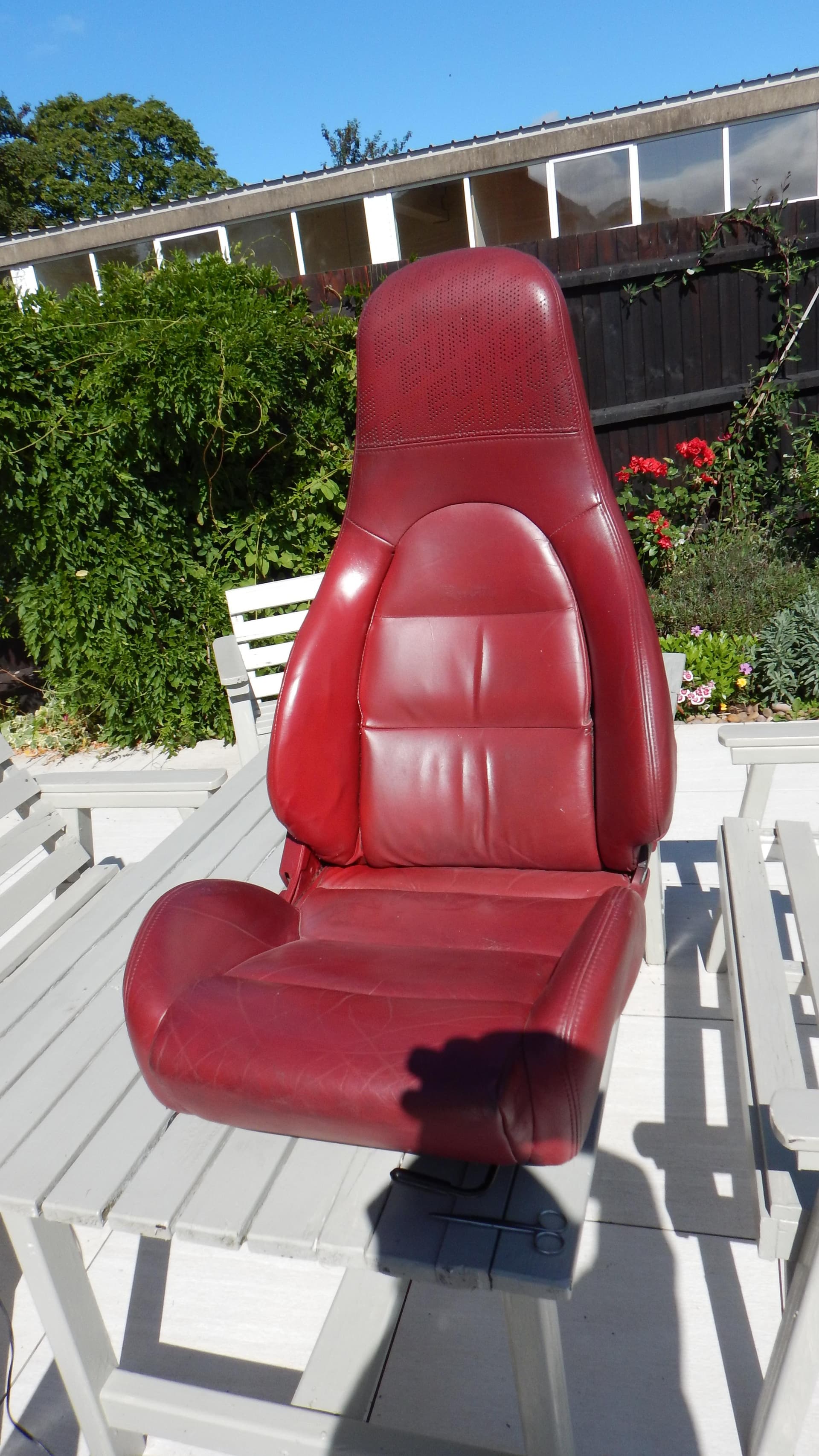

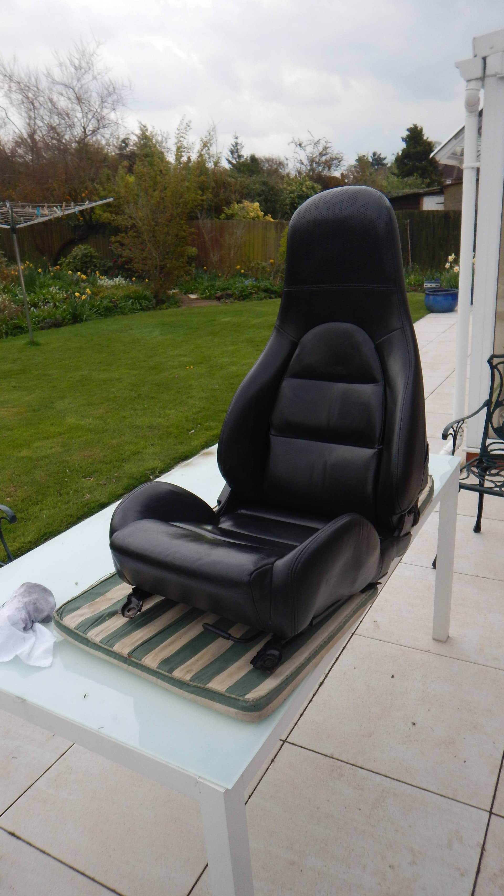

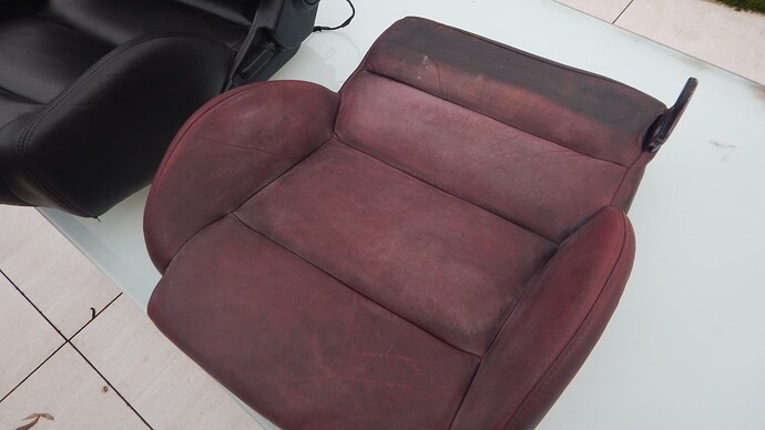

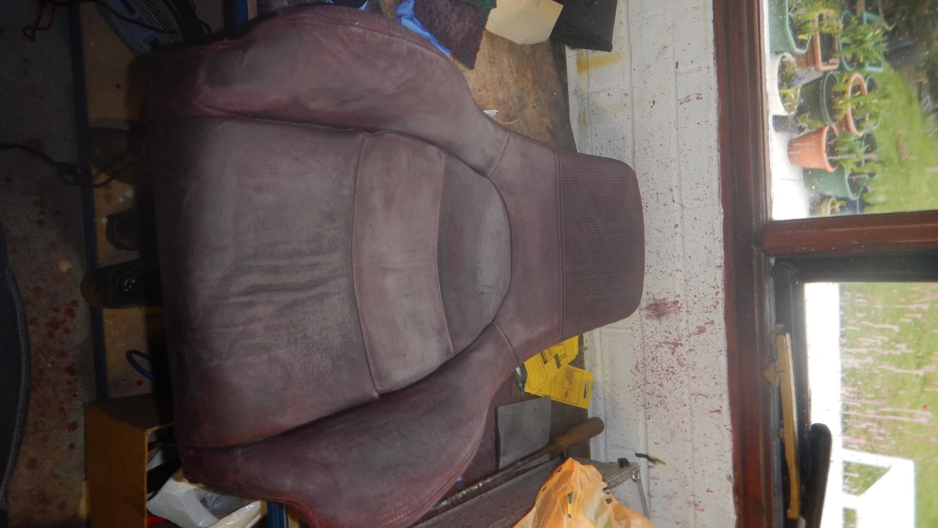

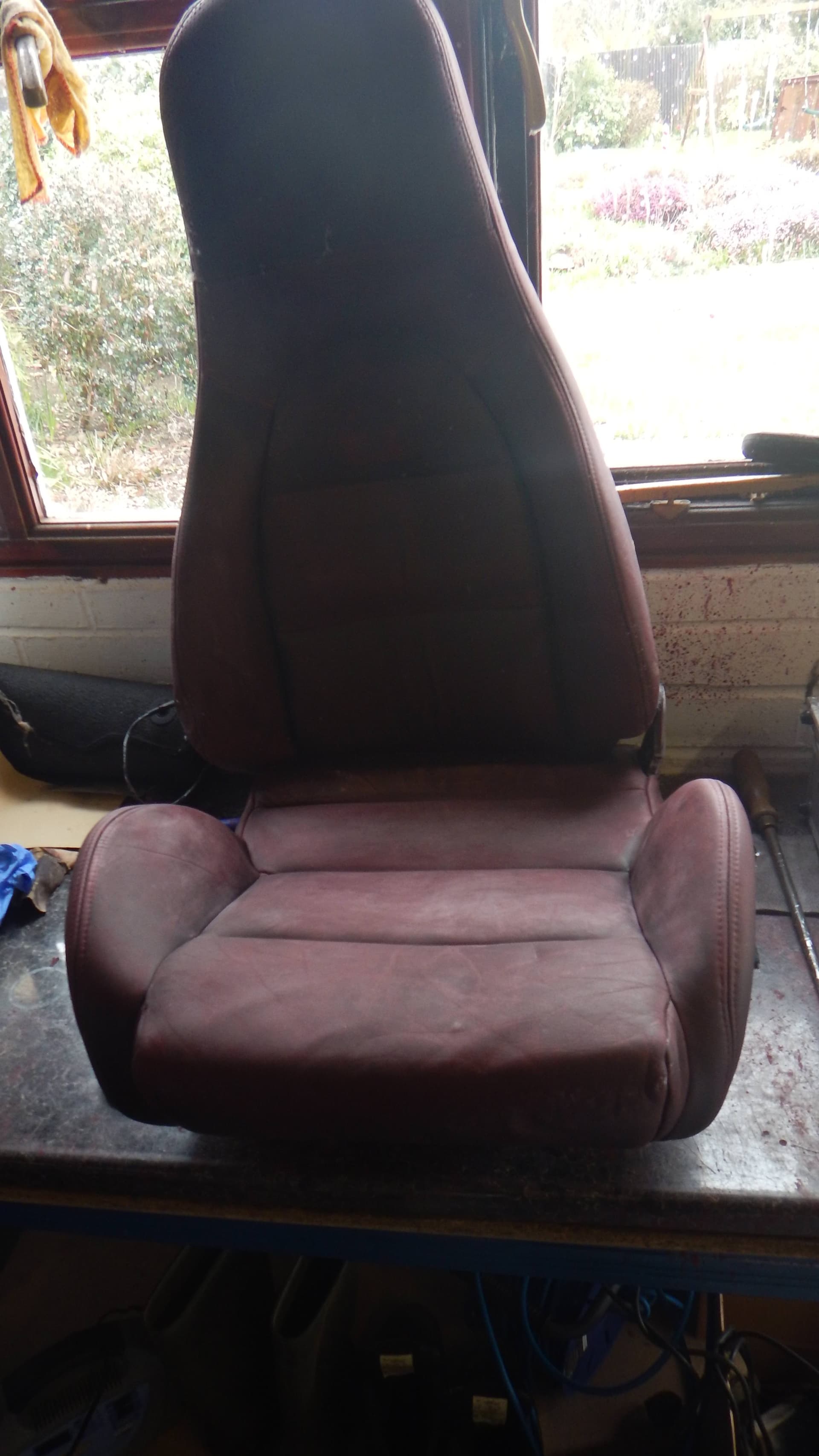

A previous full seat resto I did. Seats were black nubuck factory option, that had been recoloured red, I wanted them back to black, and settled on a glossy black.
Start. Note the red leather paint wear (about 5 years after these had been recoloured)
This is brutal. The seats were taken apart and as much of the red paint was removed as I could using wet and dry and thiiners
And finished

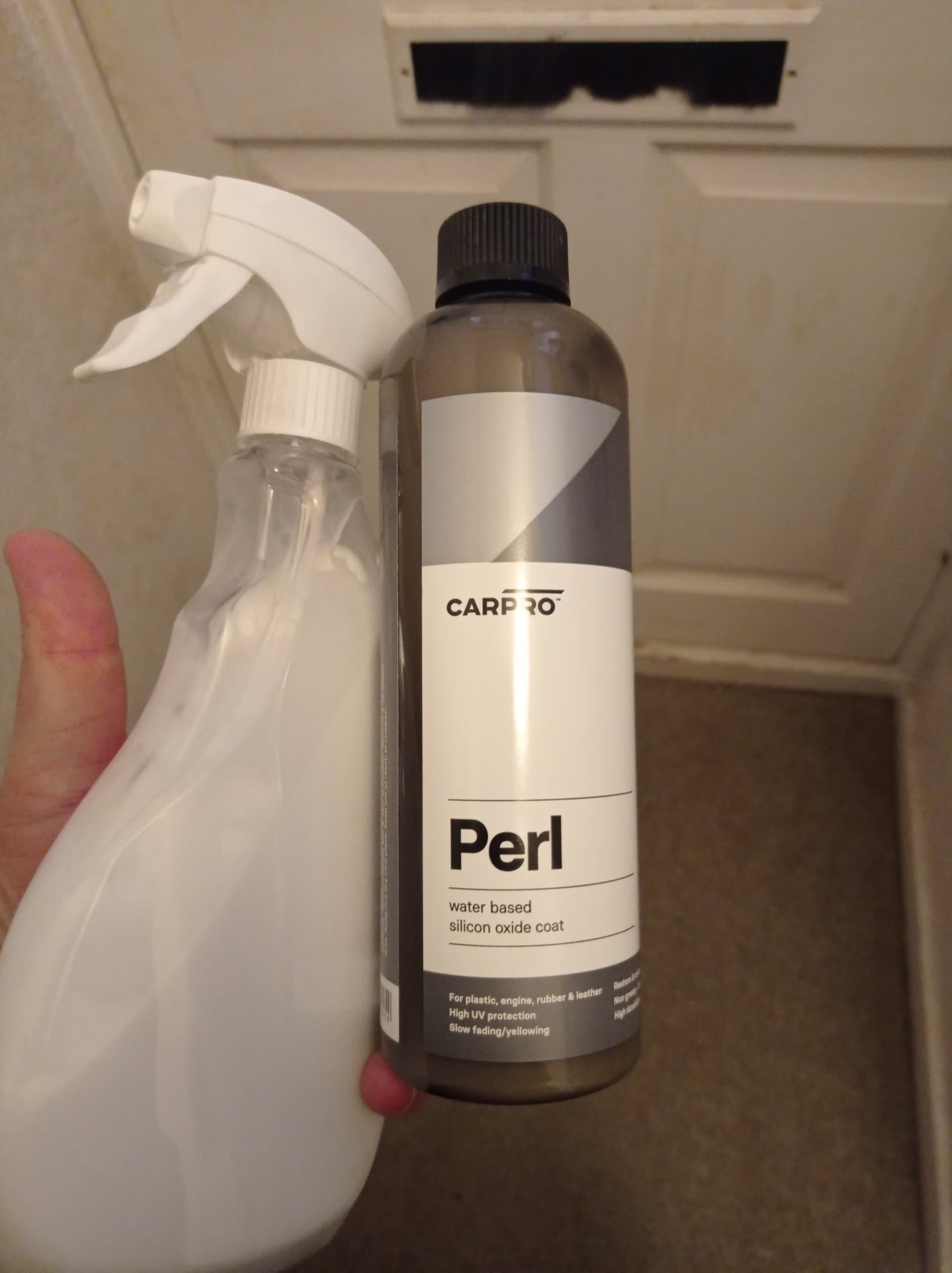

Prevention is better than having to deal with any repairs… this is some good stuff for treating and extending life of leather and seals

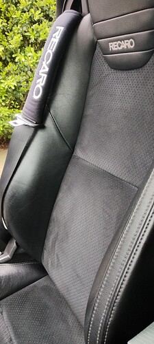

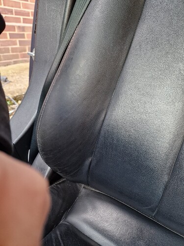

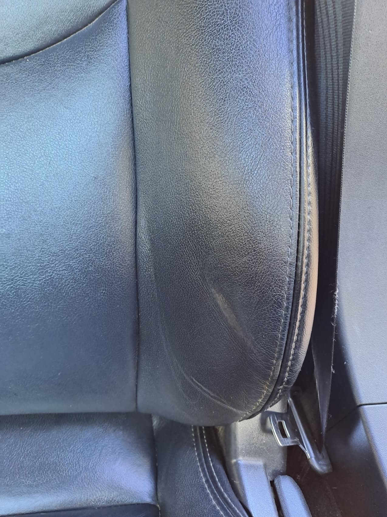

Thanks all for the input :+1: i choosed the shoeshine option and consider this a "temporary " fix…because; 1. i’m not the handiest guy and achieving a perfect result (colour match) is beyond my capabilities, a good kit cost money which i prefer to save for …point 2.
2. due to point 1, later on i might go for a professional repair . In the meanwhile i must say that the difference (altough still visible) is way better, the pasenger side which had also (less) bolster wear is just perfect now. Considered the fact that it’s such a simple handling i have to say i’m pleased with the (temporarely) result.

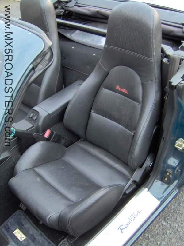

Rare factory option seats. Very limited info on these seats, except fleeting catalogue images:
The difference in shape compared to the standard seat is pronounced:
“Eunos” is also picked out on the headrest
As well as “Roadster” embroidered
Love them :stuck_out_tongue:, they look a lot more supportive too, do they sit lower than the regular seats? They look a bit like the Porsche 944 sport seats.
