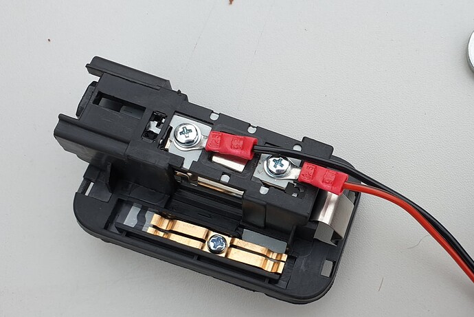

Similar process to how I did mine.
On the ND, I removed the courtesy light and connect the red and black cable from the new welcome lights to the bulb terminals of the courtesy light.
When the door opens/closes the welcome lights turn on/off. They also dim down to off too, which was a fluke :grin:.
Turning the courtesy light on/off with the switch also turns the welcome lights on/off :grin:.

The light units look the same/very close, and I think you’ve done what I should have done if I hadn’t spent so long trying to work out which parts of the switch/wiring did what in which position.
(Handy Hint: close one of the doors when doing this, or it won’t make any sense. See my point 1 above :man_facepalming:)
