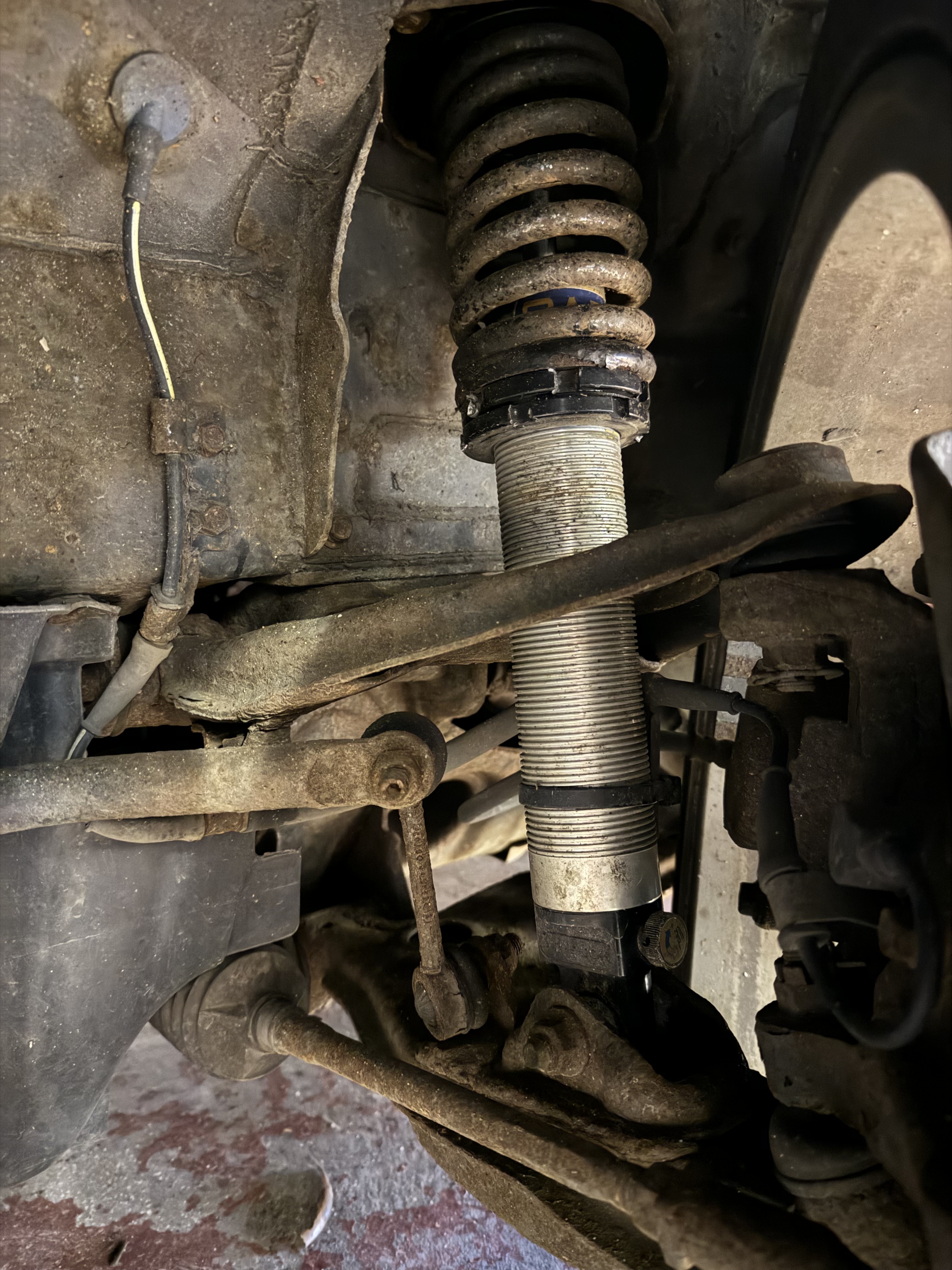

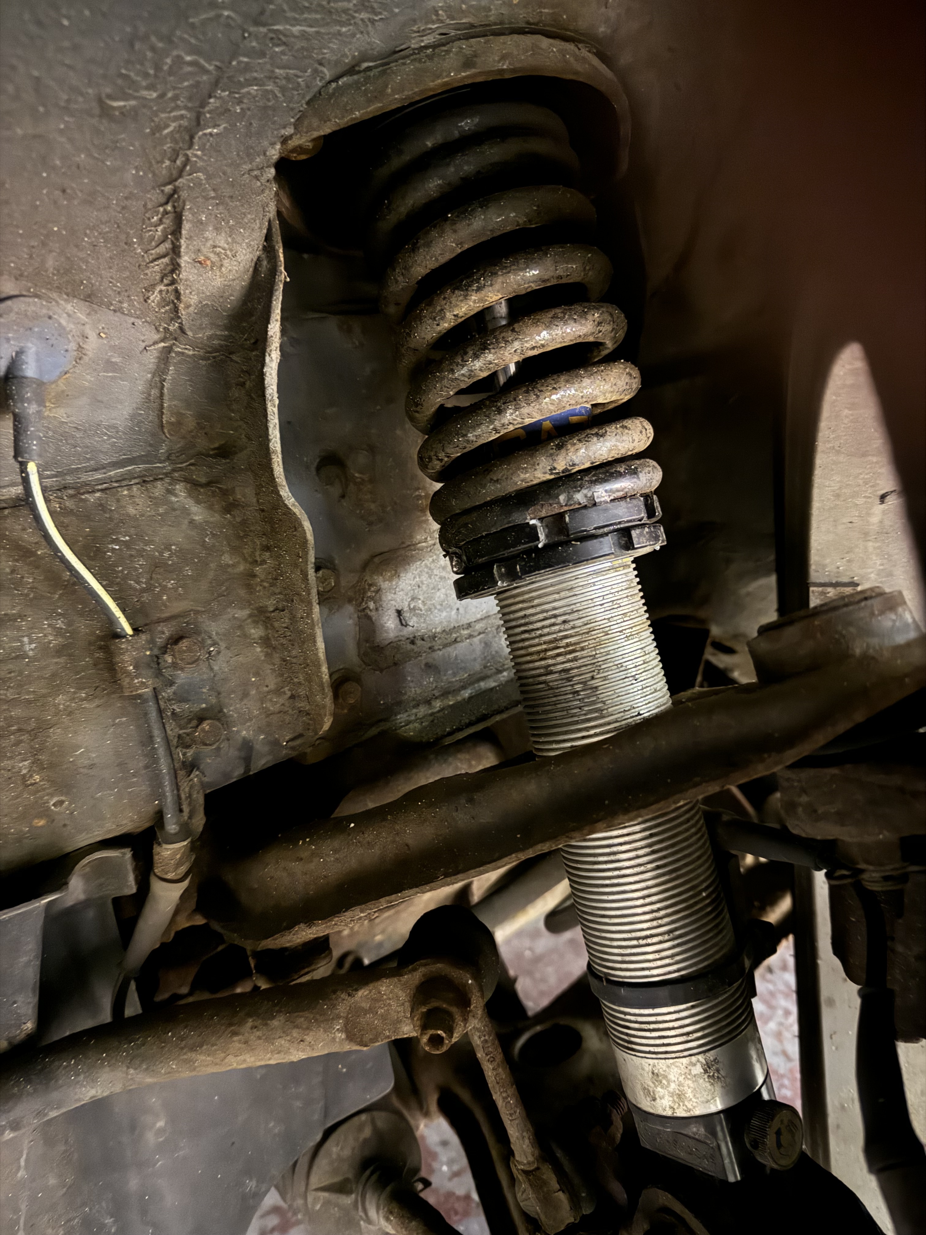

  3. I’m looking for technical help or recommendations on: Just bought an nb and I’m trying to adjust the ride height up slightly at the front to stop it scraping everywhere - it’s 300mm from lip to centre of wheel. The Gaz Gold’s fitted don’t seem to have any more thread on the shock to allow me to wind it up just 10mm - is there something I’m missing?
Hi
It may be me but that looks like a bound up spring.
The adjustment seems WAY too high.
Look at the picture on MX-5 Parts Gaz Gold Professional Coilover Kit, MX5 Mk2/2.5, I would get professional help with this as it looks wrong.
Agree adjustment is way too high - like it on all four corners. Don’t get any pinging sounds if they were binding although the rear seems to knock (feels like it’s bottomed out) over minor bumps. I had expected the perches to be around half way down so you could go up or down. Plus I can’t see any bump stops.
Byron at Gaz was really helpful when I bought a car with GAZ Gold on and wanted to increase the height, with both advice and replacement springs.
Drop him an email via enquiries@gazshocks.com .
