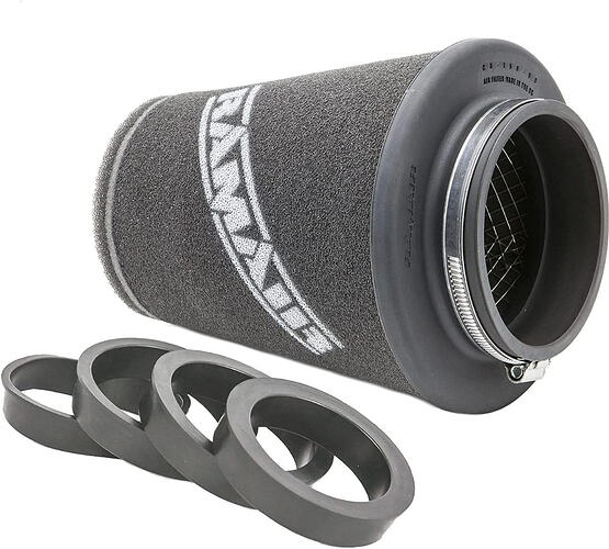

Universal cone filters come with sets of rubber reducing rings, and you use combinations so the filter fits to the MAS, secured with a jubilee clip. With a universal kit, sometimes they will come with a bit of plumbers strap that you can use to make a supporting bracket, or you can toddle off the B&Q and hunt around the hardware section for something costing a fiver.

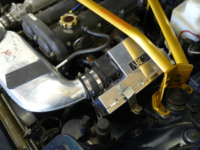

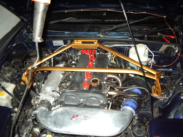

Over the years, on 1.6 and 1.8s, I’ve had various intakes. At one time I had the full ARC super intake with the rare airbox. I foolishly let the Airbox go because I thought I was selling the car. That was 10 years ago. Still have the car. Truthfully, the car doesn’t really miss it, but it did look great.

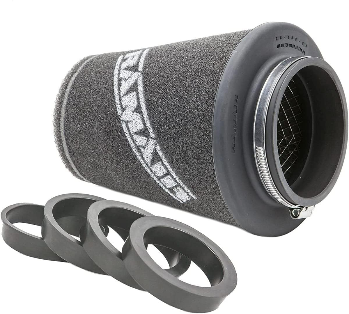

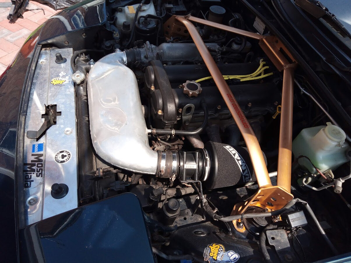

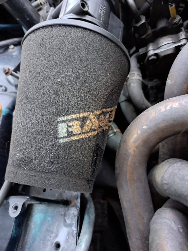

For a while, I had a Ramair filter. brought off Amazon, Ramair Filters CC-296-UNI, currently £48

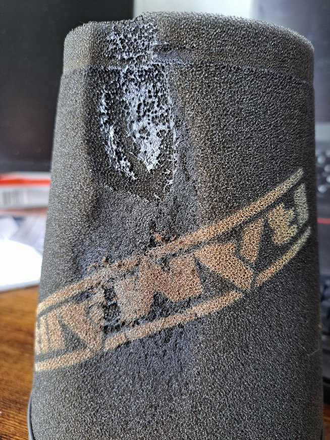

That was ok, until a mechanic left it resting on the manifold
Its probably ok still, but now have random no-brand cotton filter

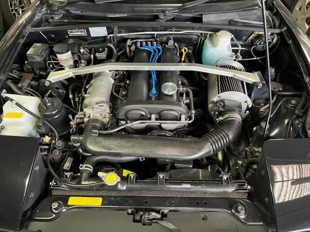

HKS

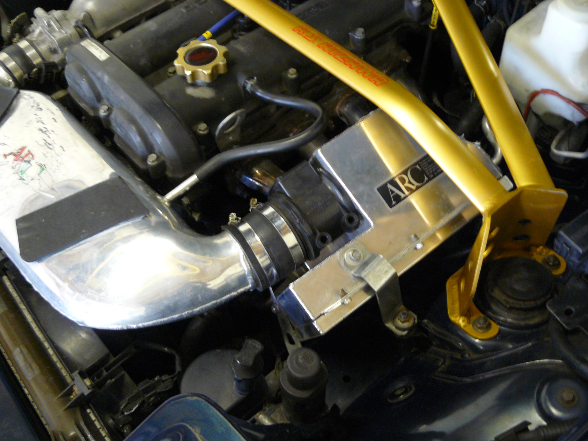

The ARC Airbox. Hmm.
You can add heat shields, hosing, it doesn’t really make any difference

thank you for such a detailed reply, with great looking photos. very impressed with your different engine bay set-ups there. epic strutt you got and nice n clean. in answer, 1.6. my motivation certainly wasn’t anything to do with making it go faster :grinning_face_with_smiling_eyes: its more of an aesthetic thing. its showing its age and is probably the tattiest item in the bay. same with the pipe, it’d just look better with a new one. so many different shapes though, i’m wary of getting one that ain’t gonna fit. thats why very interested in club folx such as yourself saying which they prefer. gonna take my time and go through the text properly now. lot of info in there :+1:

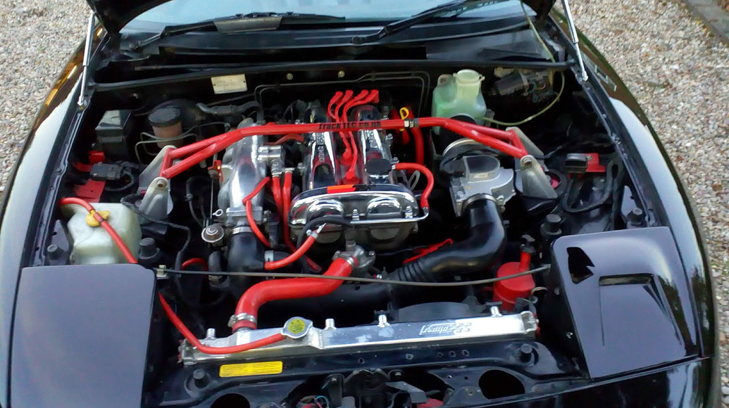

For a 1.6, if on a budget, get hold of something like this, then you can fit a generic cone filter.
On a 1.6, this cost me £40-50 from Fast Eddy in Norwich; all he did was pair up an adapter and a cone filter.
chrome looks amazing there, i got the special high tempy black paint to do mine but might go chrome now. lovely set of silicone pipes as well :+1: i’ve definitely got one of those adapters already on, but something else i might swap out.
