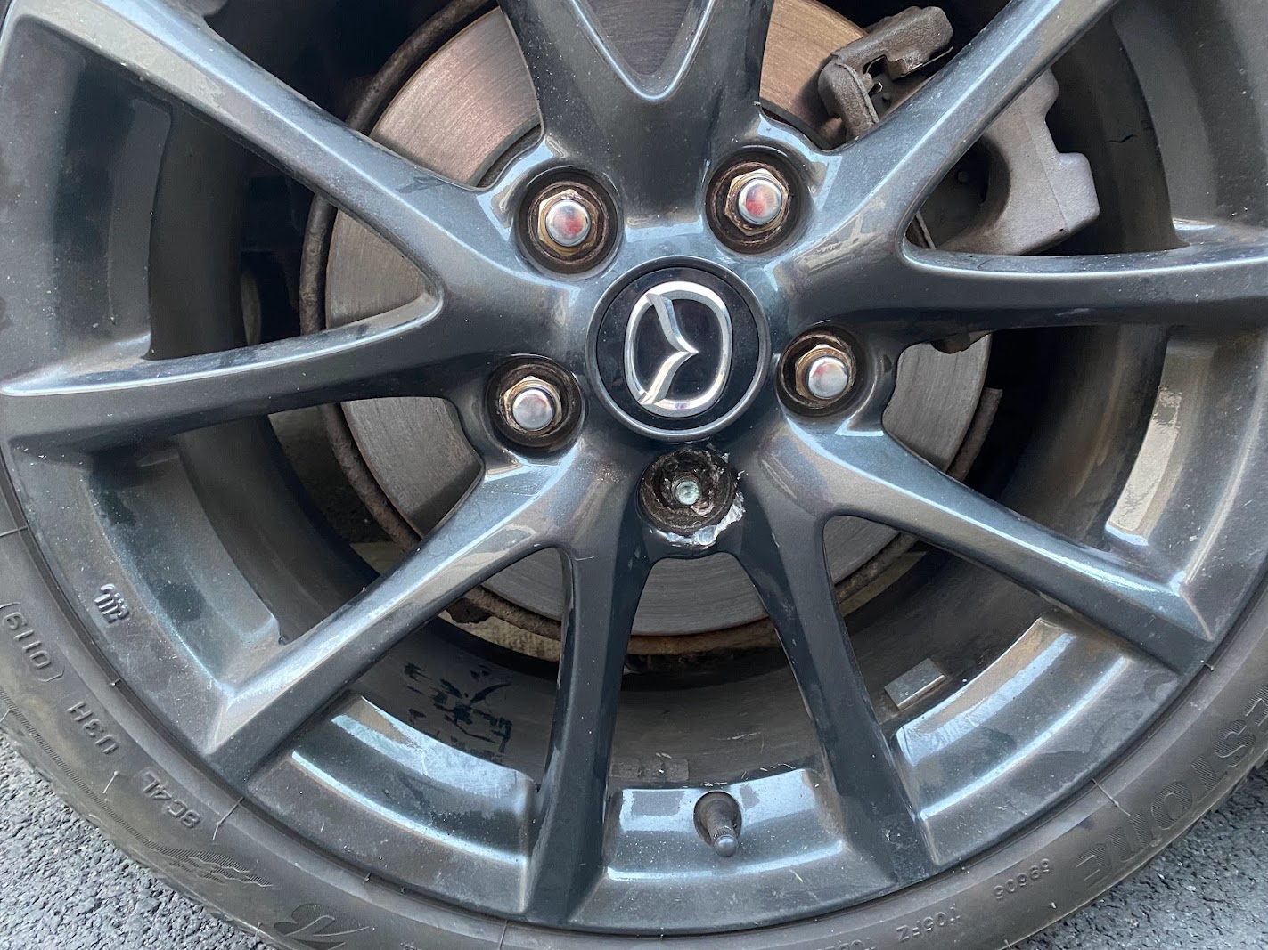

Has anyone ever experienced their adapter thingie for the locking wheel nut snapping?
I had my car in the main dealer at the end of July for new rear brakes and pads.
Had the car in at a different garage this week, and the locking wheel nuts were tightened so firmly that the adapter snapped (sheared). I’m trying to work out if this was (a) the main dealer over-tightening the wheel nuts six weeks ago or (b) the new garage being heavy handed. Or of course (c): Both!
Is this a common issue?

Here’s the mangled mess I’ve ended up with.
“New” garage asked me to come collect the car, and to get the main dealer to remove the locking wheel nuts.
Booked in at main dealer next week. For both of these garages I am “the customer”, but I suspect I’m going to end up holding the bill on this mess.
It’s a shame that the second garage didn’t stop work when the locking wheel nut key broke and offered you the option to go to the main dealer and have the nuts removed using their master set.
Agree.
They could even have saved the day with a set of lug nut removers rather than doing so much damage to the wheel
Absolutely, Robbie. Completely agree. And indeed, in a phone conversation with me, we agreed they’d phone the main dealer. Sadly they didn’t. I had no idea that they were continuing to use “blunt force” to try and get the nut off.
No names for the moment. But I feel very let down by both the Mazda dealer, and the independent MX5 specialist garage that has damaged the wheel.
I’m really not sure what the main dealer will be able to do at this stage to get the wheel off.
Nick
That’s not on at all. How have they managed to do that much damage to the wheel?!
I’d suggest they’ve taken an impact gun to it. Which, as Robbie says above, is not the recommended method.
Yes, sometimes wheel nuts are overtightened. It happens. But as a professional outfit, you recognise there’s an issue and then work on a solution. What you don’t do is butcher the wheel THEN inform the customer :rage:

Yup, definitely getting the remaining locking wheel nuts removed.
Nick

Happy to report back with a positive update on this “stuck wheel nut” issue.
Wonderful team of mechanics at Walkers Garage in Sale gave my MX5 a full service this week. And they spent a bit of time, energy and love removing the wheel with the half-drilled out nut that “a different garage” had bodged so badly. They also rubbed down the damaged bits of alloy, and put some paint on it. Lovely to deal with a garage that applies so much love and care.
Top result! :+1: :1st_place_medal:
