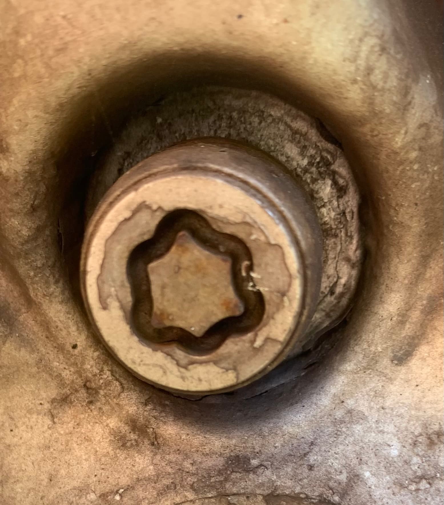

Lost locking wheel nut. Can anyone identify?
Hello all
Just went to service my breaks and my wheel key is no where to be seen :man_facepalming:
Any idea on the code for this shape or what my options are?

Looks like a MCGard wheel lock. These ended up being fitted by Mazda UK.
If you haven’t got a key code, there are various ways online to take these off. Not going to post a link for obvious reasons (why make it easy for them).
Looks like a code 913L. Mazda supplied McGuard wheel nut, your dealer should be able to remove it with their master set. While it’s un-damaged, IMO there’s no point it trying to got it off without a key.

After misplacing my wheelnut key, I went to local Mazda dealer and, using their master set, were able to identify the code by trying each one in turn until they came to the one which fit. New one ordered, which arrived at dealership within a couple of days. They asked for proof of vehicle ownership before supplying.
Thanks. I’ll see what I can order. Brakes are sticking so and dealer miles away so don’t really want to try drive it to them. Appreciate the response and amazed you can identify the code!
It’s a sport so the wheels might be worth nicking. I’ll get some new locks on order now…
Thanks. Brakes sticking and dealer miles away so can’t really drive it there! I’ll see what I can order for the code Roadster_Robbie gave me :slight_smile:

There may be a sticker in/on the glove box to confirm the code or a piece of folded card in the owner’s wallet with it on. The last 3 digits confirm it from memory. I’d hate you to order the incorrect one, although I’m 99.9% sure that the code I’ve quoted is correct, I’m working from memory.
Just email McGuard with a picture and they will sell you a new one.
Ask how I know… !
Me too, McGuard were cheaper as well
