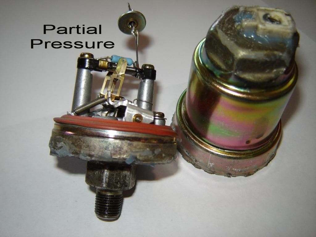

Looks my oil pressure sender is about t die; oil pressure at idle hardly registers now, but the engine is rattle free. This is the inside of a 1.6 sender unit
Lots of moving parts. MX5parts want £100 for this. Used places want £30-40 for 20 year+ used parts that are probably about to go pop. Anyone know if pattern MX5 sender units actually exist. Not oil pressure switch; thats just for the later car.
So there’s a diaphragm that operates a bellcrank and a wiper on a resistance coil to make a variable rheostat and a resistor. The Mazda published Manual says that
0 = 52 Ohms
30 = 41 Ohms
90 = 16 Ohms
Unfortunately the transducers in modern Eurpoean senders seem to use a resistance range of 10 - 180 Ohms for this pressure range although there is an American type with a range of
0 = 240 Ohm
50 = 103 Ohm
100 = 33.5 Ohm
Perhaps there is an electronics wizard in the club who could make a circuit to allow a modern sender to be used.
