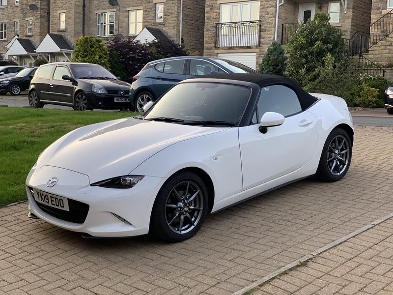

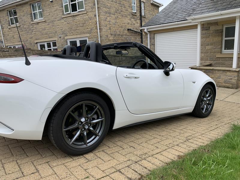

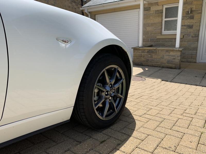

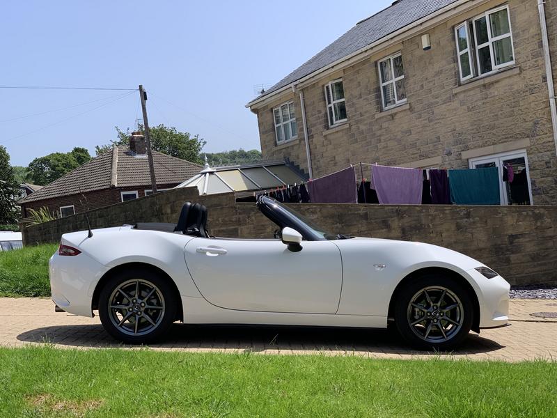

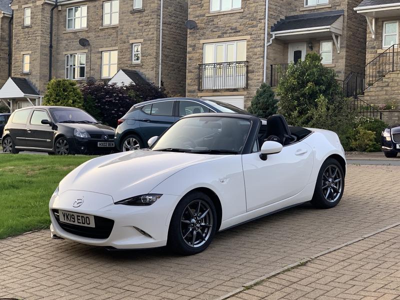

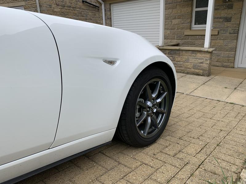

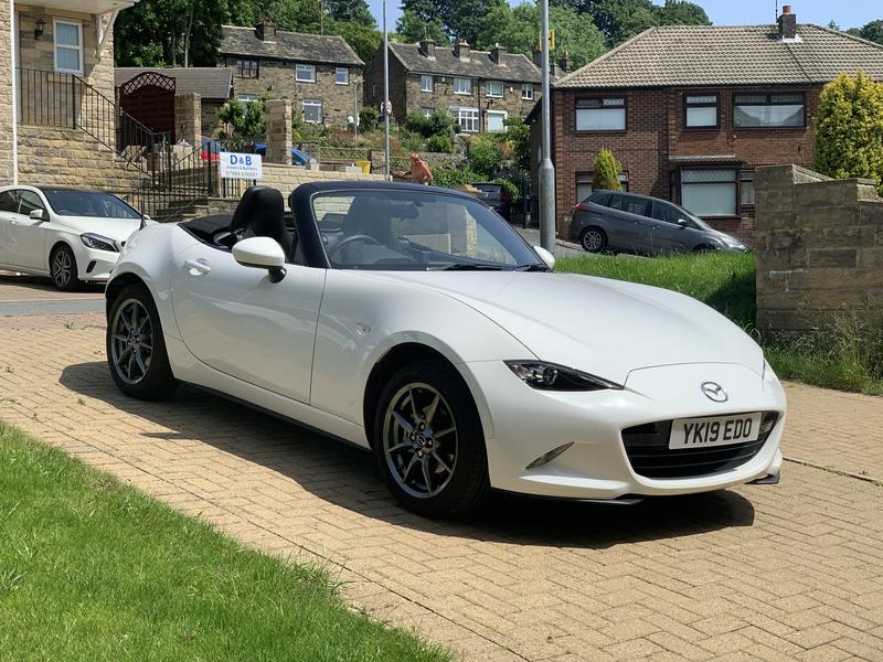

As promised, here are some before and after pictures. I’ve tried to use the same angle so there is a direct comparison. I think they will settle a little lower, especially the back, but already a big improvement.
Before
After
Before
After
Before
After
Before
After
Looks awesome, I’m considering having the same things done…
Thanks. Now they have settled they look even better. Also, no headlight adjustment was required so don’t opt for that unless you need it afterwards as it’s not cheap. My springs were less than £100 and fitting was £100, so for less that £200 it’s a no brainier.
