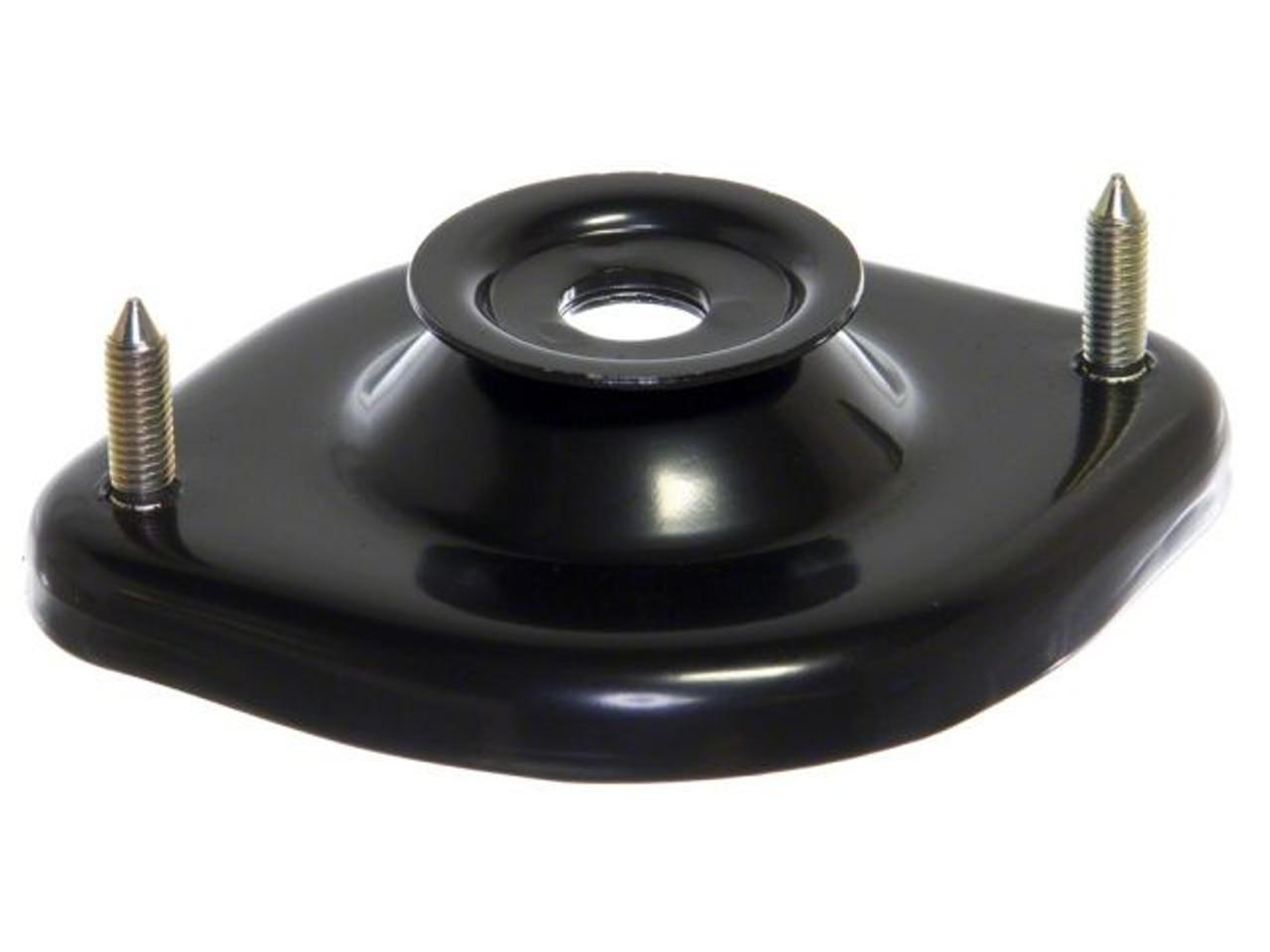

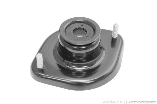

ILM also sell the Mahura part for cars with the NB suspension
Aftermarket
Factory part
