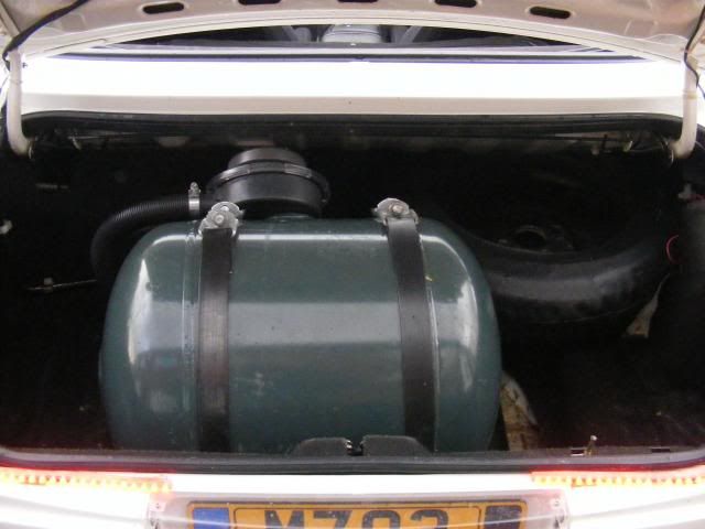

Any photos of the boot?
This is mine
Takes about 32 ltrs, but is a 45ltr tank, can only hold 85% of tank size due to expansion of the gas.
not as bit as i thought it would be
You can get a doughnut type tank, i have seen a MK2 with that, but i wanted to keep the spare wheel and this was the only it could be done.
The tank sits in the bootwell so if the floor was flat i would have to have a smaller tank.
I’ve also seen one along the back of the boot, but it was a smaller tank
Hi I will take some snaps of the tank but mine is a round wheel shaped one that goes in the spare wheel spot. It takes about 32 litres which is as much as I can get in it. I would love a larger tank.
