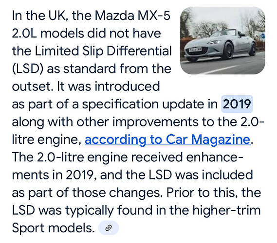

Thanks for context this is the google AI result that I’m referring to
If you can’t trust ‘AI’, what’s the world come to.

Well quite. Hence the question to get clarification.i was mainly trying to understand how unique/ rare or not it was on earlier 2.0l cars in particular

Maybe Car Magazine got it wrong?
