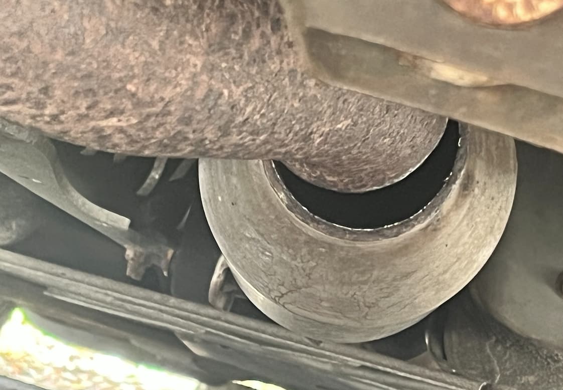

My car has lowered Eibachs and Bilstein shocks (bought it that way) and I keep grounding out on country roads. There was a big noise a few days ago and I’ve snapped my exhaust centre section clean break. That fits into an IL Motorsport backbox (also came with car).
I’m not sure if any of my local guys would weld, so I’m just considering replacing the whole centre section with something highflow as at some point in next few months, I’m planning a BBR s/200 kit.

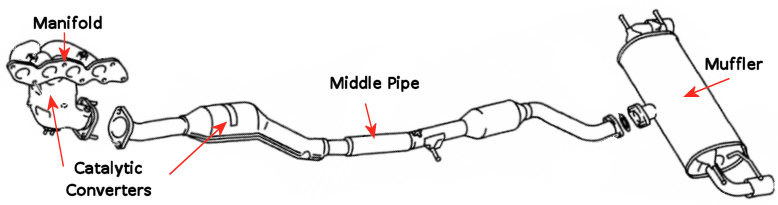

From what I can see there is a cat on the exhaust manifold, a secondary cat on the first part of the center section and the second mid pipe has a resonator.
I have yet to find anyone selling just the final mid section alone, just de-cat removing the secondary cat and resonator, but that would be an MOT failure.
So I have found this diagram.
This de-cat would remove the secondary cat, unless you just used the final section and left the secondary cat alone?

Mine is broken just at the rear before the resonator and back box.

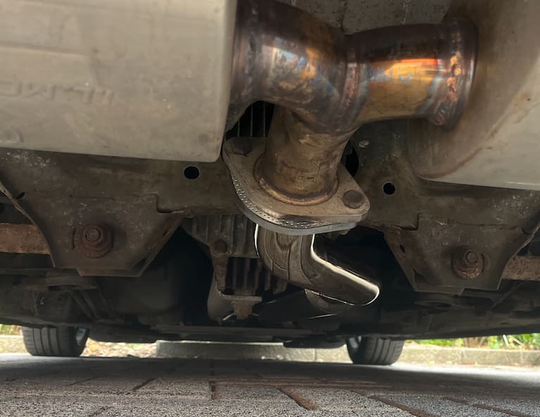

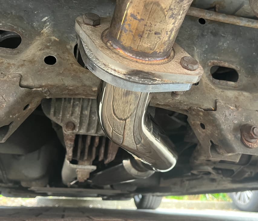

I went for the (MOT) safe option and got the 200cell cat from Milian. Managed to pick up same day from Bofi and fitted it this afternoon.
It’s excellent quality, fitted perfectly. Gives a nice deeper sound to exhaust without really increasing the volume or drone.
