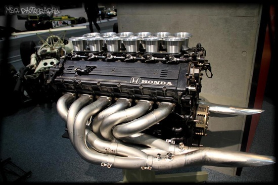

Indeed there are. The best performing manifolds have near equal length headers which is why some look like they’ve been badly put together while others are neater. Quite often the neater ones have unequal length headers however quite often the car wont allow more than neat and compact headers.
If you want the most out of one then look for manifolds/manufacturers that have equal length headers as that ensures the correct pulsing.
Good example below
Honda engine
