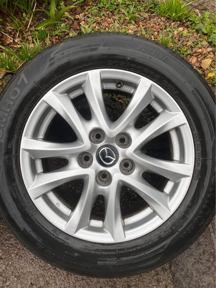

Hi all sorry if this is a stupid question I just want to be 100% sure in my head before I spend money. I want to change the wheels on my MK3 and have seen a set of Mazda 3 wheels that I like the look of I’ve found an old post that says that 17" Mazda 3 wheels will fit so is it safe for me to assume that the 16" will fit?
Mazda 3 is 6.5Jx16 ET50, PCD 114.3, Offset range 48-52
Mazda MX5 is 6.5Jx16 ET55, PCD 114.3, Offset range 53-57
Are the ET50 and the offset range (I’ve got no idea what these are!) important? And would my current tyres fit?
Thanks Mike
Yes, they’ll fit. It’s worth checking the weight of them before you commit though, as my guess is they’ll be a fair bit heavier which isn’t good for ride or handling.
Thanks I’ll investigate a bit further. This is the type I’m thinking of. From what I’ve found so far a bare Mazda 3 hub weighs 8.6kg.
I think that’s about 2kg per corner more than the standard NC 16” wheel, which you’re likely to notice. People pay a lot of money to reduce wheel weight by a similar amount.

Are you planning on using the tyre size that the Mazda3 wheels come with?
Just that they use a different profile for 16" and run a 205/60/16. Which won’t do MX-5 handling any favours and will look a little odd as well.
If it were me, I’d drop to the NC2 16" OEM wheel option, if you want a bit more ride compliance. On my old NC2 I ran 17s spring/summer and the OEM 16s on an all-season tyre for autumn/winter.

My hope was that the Mazda 3 wheels would be ok because I liked the look of them, they are in good condition and a sensible price, £150 for the set.
My thought was to fit my good set of Toyo tyres from the original 16" rims to the Mazda 3 rims.

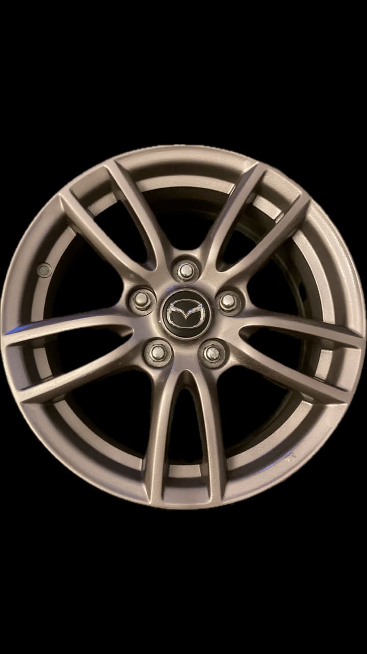

Does anyone know the weight of the 5 spoke alloys?
Ah what a shame. Yes I can understand why you’d want to try and move on from that!
I’ve got the NC2 16” listed at 6.8kg wheel only.
