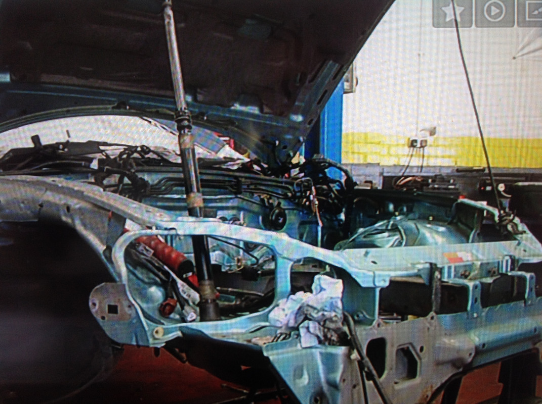

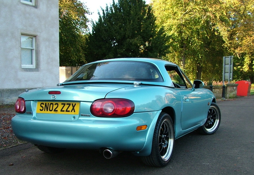

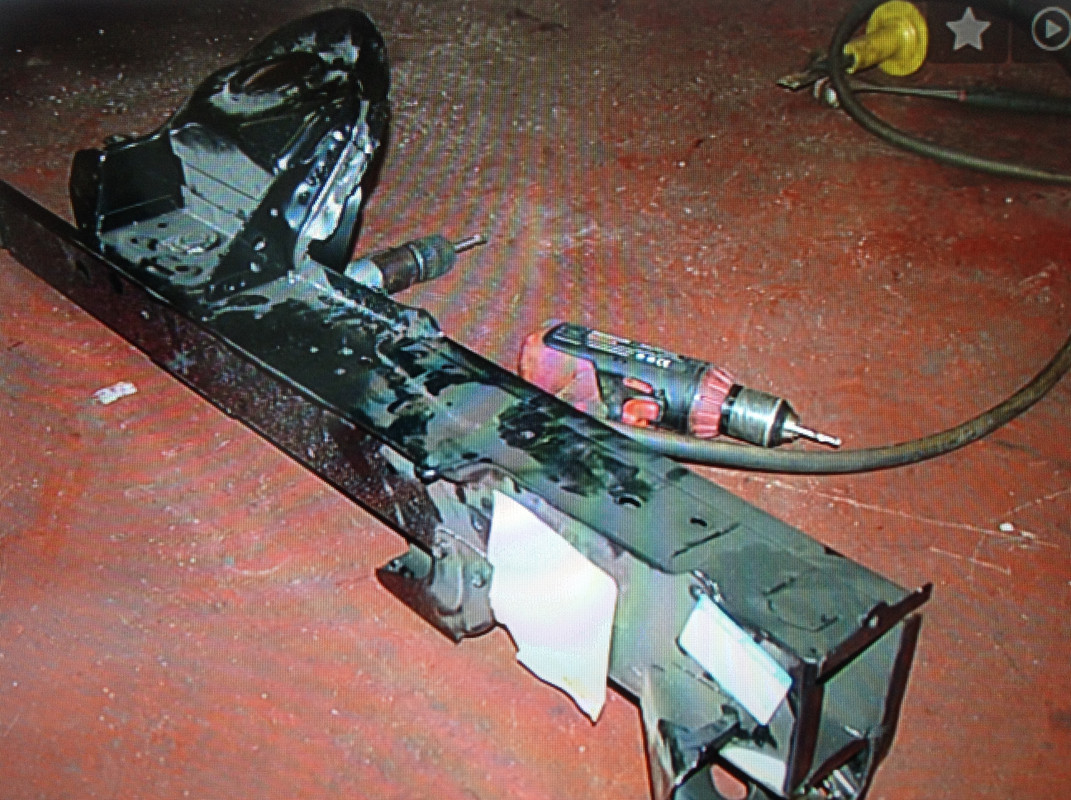

The chassis rails were £800. The rest of the work was sills, arches, every single rust spot and bubble removed and repaired (metal, no filler), a few mechanical repairs and a full strip and respray. Over 3 grand.

However, you simply must have the Devil Spawn double skinned engine bay chassis rails vigorously inspected. This may mean dropping out the front bumper, but if you drop the plastic tray and get it hoisted, you should see any impending rot issues like “swelling” especially around the ARB mounts. If you see rippling or whatever, they are going back to oxide inside…ready to erupt any old day.

Anyhow, speak to Andrew at Autolink in Dumfries come the day, and tell him Robin in Falkirk referred you. He’s one of our best “trustees”. I don’t kno0w if he does repair panels, but even chassis rail sections are now available, and sills/ rear arch sections always have been.

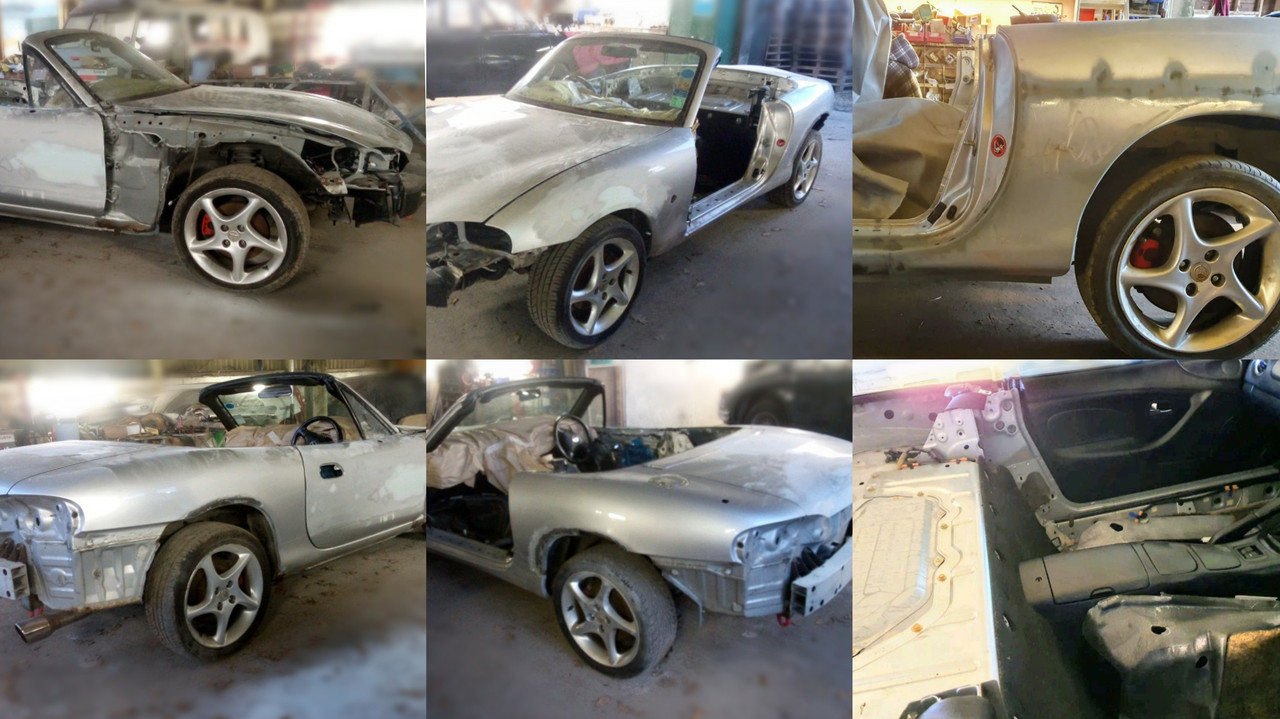

This was the extent of my repairs, it became more of a minor restoration instead. But you can get the work done to a lesser extent than this and still have similar results.
