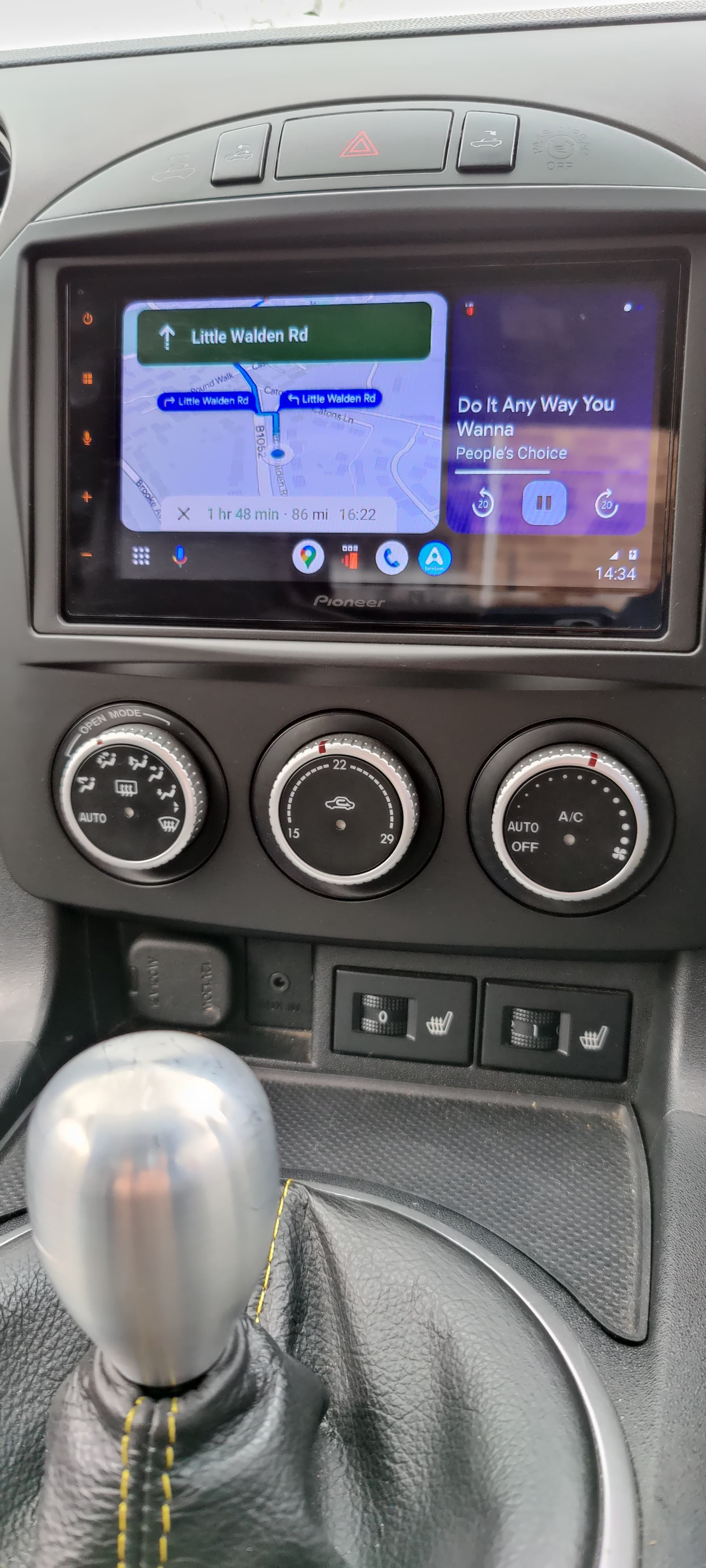

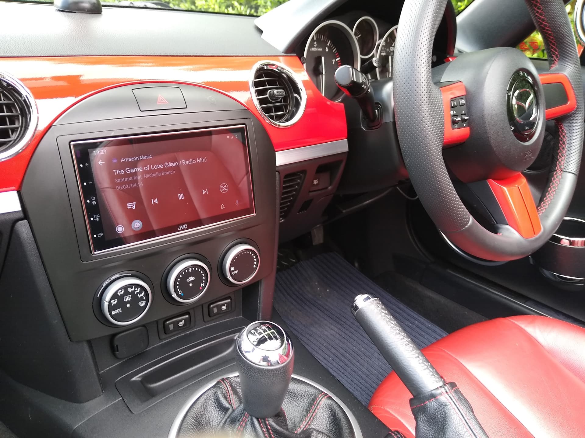

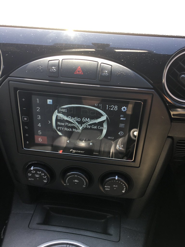

Plenty out there to be had, I think they are a standard 7" screen size. Search Dynamic Sounds website for all the bits & pieces you need including the facia fitting kits. You need a pre Facelift kit NC1 for the 2007 and I guess non Bose. The kits will give you steering wheel controls too.
I’ve fitted 2 now, well the same one in different cars.

That looks really smart.
