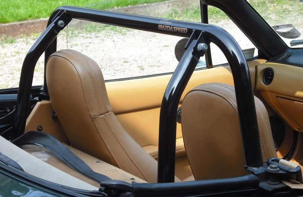

Hello all, I recently discovered that my Eunos V-Spec has what may be a Mazdaspeed rollbar? My only reason for believing this is a mazdaspeed item is because of the sticker though! Can anyone confirm whether this is or not? Are they rare/ sought after as I’m not desperate for it, but having recently rolled an MX-5 I quite like the feeling of having a rollbar!
Thanks in advance,
Duncan
 Looks like the same as the one I had.
So your on a JDM winner there…Fetch good money on fleabay.
But do understand thats its just a sturdy looking stylebar as it bolts onto the flimsy sheet metal of the parcel shelf…Not a full Roll bar.
Alan
