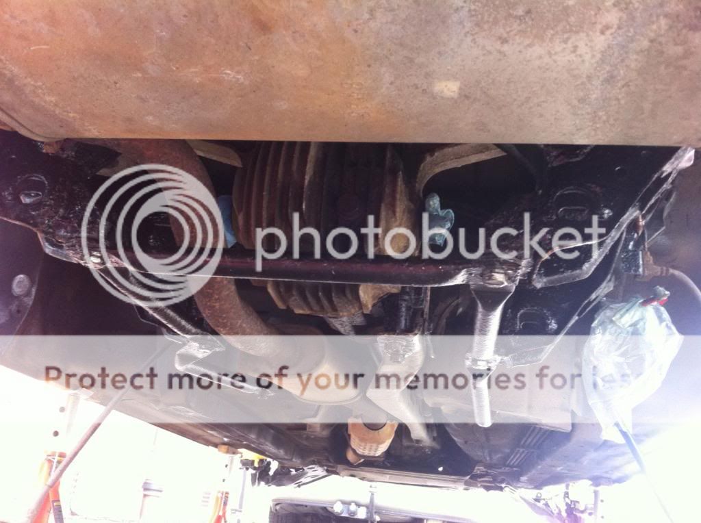

Although it all looks crusty underneath, if it was really rusty, the garage would have hit problems extracting the rear shocks, and the lower shock bolt seizes up, and breaks the captive nut inside the wishbone. That they didn’t suggests that under all that underseal, everything is fine.

Just the 90hp 1.6, I suppose to reduce weight, not cost cutting. You don’t have a cockpit brace either.
Now, the original designers allegedly didn’t want the rear brace on, as it tamed some of the handling characteristics
Front brace, fitted on 1.8. This is aftermarket, but they mount in the same spot. I think yours should have threaded hardpoints to use.
Rear brace:
This is factory 1.8; the longitudinal braces are sopt welded, so can be split. You should have threaded tangs on the rear subframe to accept this. I’m not sure you have the threaded hardpoints on the floor pan though. On rusted cars, the captive nut on the floor points can break off.
There are also aftermarket versions.

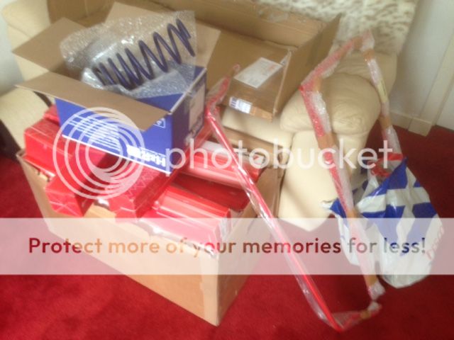

Right! This spending has to stop!  Another box arrived today addressed to Mindy. What has the wee minx been buying herself this time?? Something very nice, thats what!
All will be revealed tomorrow. Think this is what is known as teasing! Lol
What, you literally have parcels sent to your car, address “Mindy the MX5”, or “Mindy, Dave’s MX5”?
Ruddy lightweight you are my lad.
Koni Street kit.
New SS exhaust
New Panasonic battery
New chrome IL wing mirrors.
New tyres
New sills & arches
Track rod ends
New discs
New calipers
New brake hoses
New Autotrans sump
Hood & Frame
Anti roll bars
Drop links
Boots
Refurbed wishbones
Ohh…plus extensive rot proofing.
