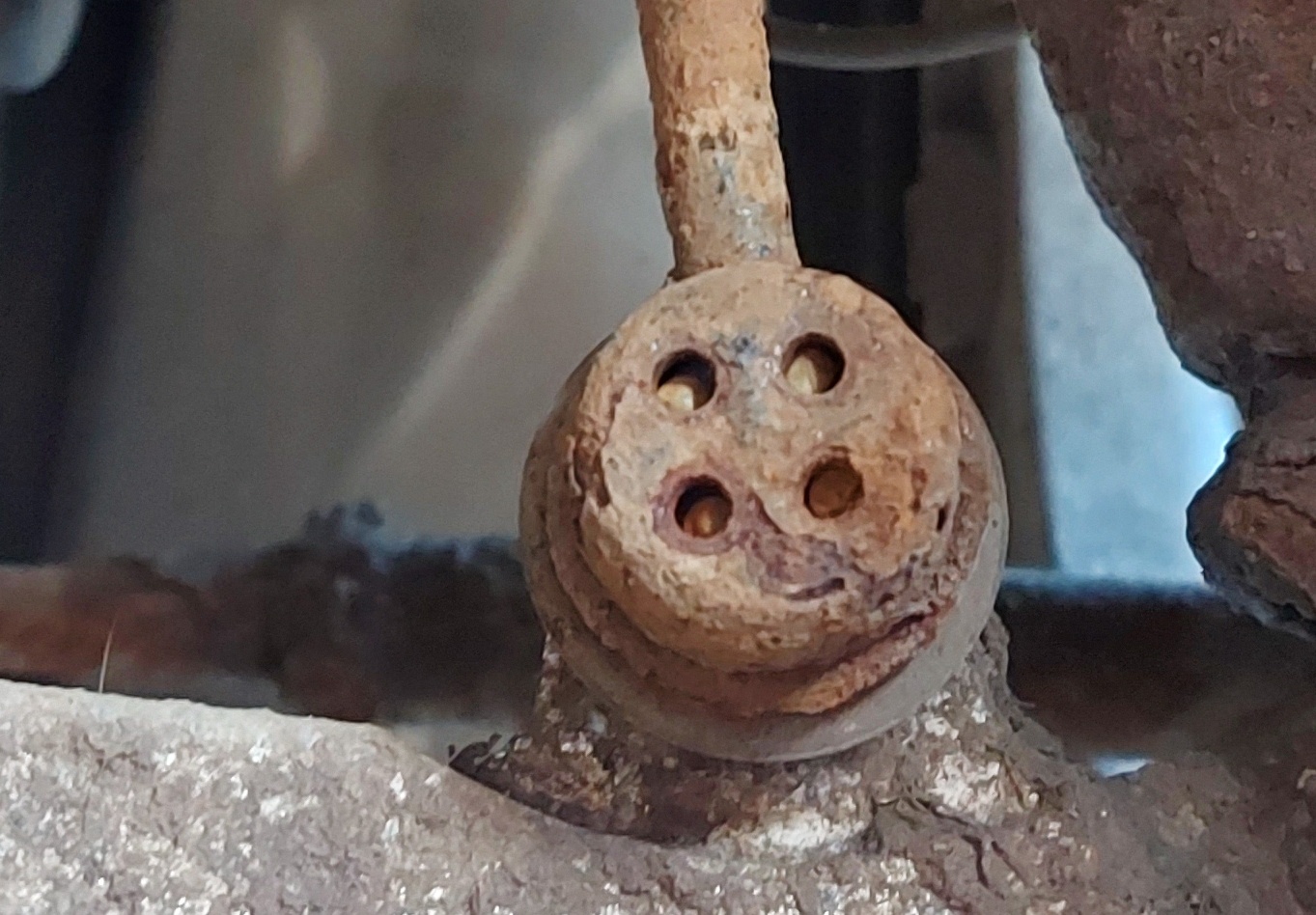

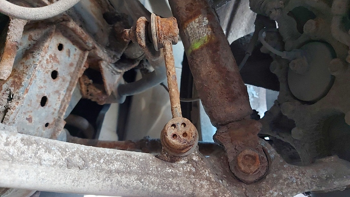

    I was out earlier and went round a mini roundabout the painted hump type, and the drivers side wheels went over the lower part of the hump and there was a metallic bang, I looked under the car both sides and noticed that on the drivers side on the front, there was a small metal rod which had broken away from its position and was to one side, it seems to be part of the steering / suspension, so I pushed it back on and took a photo, as it looks different to the passenger side ,the bit with the four holes in it is the bit that came away, see photos crud and all.

Are you saying your stabilizer link came undone and popped out is the nut missing or where it joins is broken.If it’s the link its a £10 part.

The upper drop link stud goes through the arb and held by a 14mm nut. The lower stud goes through the alloy mounting lug on the lower arm. If its detached then either the 14mm nut fell off or the stud sheared or the alloy lug broke off the lower wishbone ( hope not)

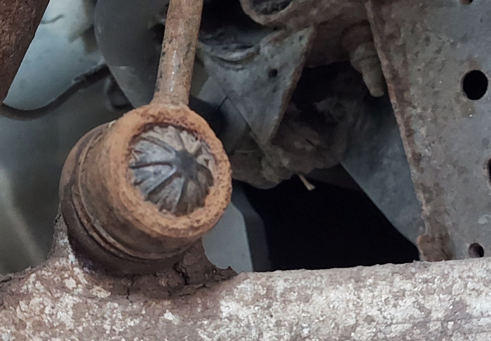

The bottom of the link felt like a cup ( the round bit with 4 holes ), and pushed back on to the fixed bit and stayed there, here is a cruddy photo of the bottom of the link on the passenger side if its any help.
So the socket of the drop link has failed. Thats option 4 on my list of three. Shouldn’t be too difficult to remove with care
