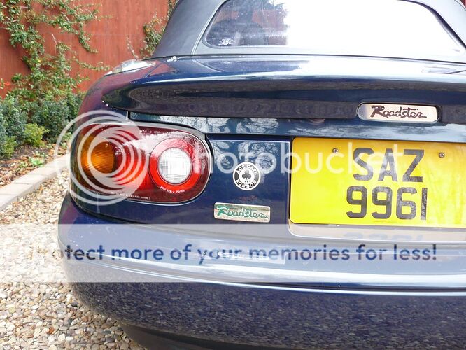

I got pulled a couple of years ago in Watford, and was issued a fixed penalty for this plate:
When I changed the red 91 Roadster (above) for the blue 1996, I also transferred the registration plate. Foolishly/naively, I reused the plate that was on the 1991 Roadster on the 1996 Roadster, since it was a perfect fit. The plate had been on the 91 car since 1997, with no issues, and transferred over in 2005. Mistake. I hadn’t realised that as the plate change was done after 2001, I should have got a new plate. The police officer was apologetic, stating if he had seen it a few weeks earlier, he would have issued a Producer, but the law had changed. he wasn’t interested in inspecting the front plate while he was there.
None of the local suppliers could provide a replacement plate, with a legal font, without taking a saw to it, and removing the makers name and BS marks, hence defeating the object.
I ended up buying a plate from Craigs Plates, who do a plate perfectly sized for the Roadster. the font is smaller than stock, but the plate is kite marked, and has the makers name on.
The regs,  issued in 2001, do give a dispensation for imports to have a reduced font size, if the bodywork precludes fitment of a UK compliant plate (so no excuses about fitting a normal front plate).

Try Craigs Plates, they list import size plates
 9x7 bike plates are wrong.
The jap plate is 13" wide and varies in height ( 6 6.5  6.75 7 and 8 inches)  I have a 13x7 on my Roadster
