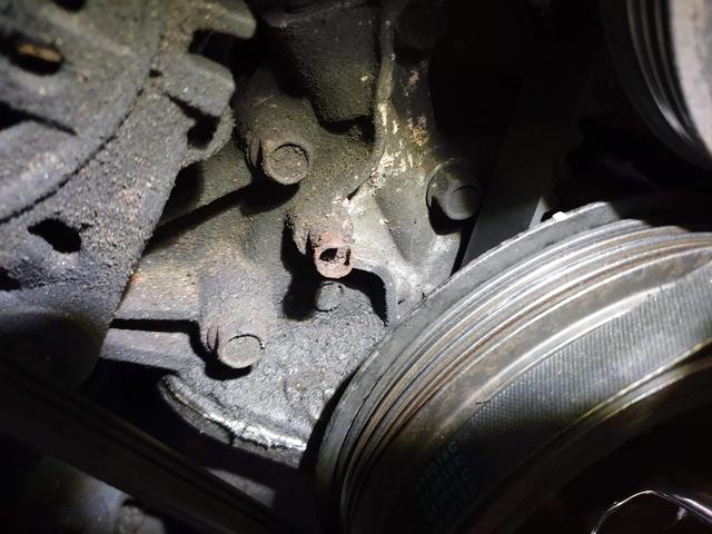

In the last few days, whilst waiting for the delivery of the MAF sensor I decided to check the previous items that were done by the garage. I started with the timing, which is by far the most mechanical job I have undertaken (all be it with verbal advice from rhino666). However all markings lined up correctly and in my limited experience, I believe the timing to be correct.
The garage originally concluded that the crank sensor was damaged and loose. So I also investigated the trigger plate for the crank sensor. I have subsequently discovered that one of the little nipples are missing and another one has a slight indent. It is now my belief that this caused further damage to the trigger plate (it is possible that it was something else, however, I have no further explanation).  I now believe this to be the reason for the failure to start. This will be replaced in due course and an forum update posted accordingly.
I have attached photographs of the damaged trigger plate for others to review if required (please let me know if it cant be viewed as I’m new to this forum but will be using this from now on).
Obviously the car is not running at the moment, but I hope that, once its back together, I will have no problems.
Again, many thanks for all you help and advice
Ryan
When you replace the trigger plate make sure that you fit the new one in the same front/back orientation as the old one. It’ll fit either way but the tags are offset to the mounting holes.
