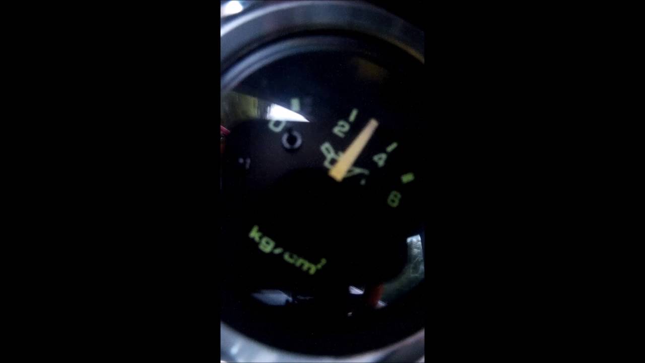

My 93 gauge behaves in the same fashion. Nothing wrong with the engine, but a failing £300 sender unit (yes, those early sender units are expensive).
2kg/cm2 at a steady 70mph cruise, then at 1:55, its like someone has flipped a switch. Connectors are clean.

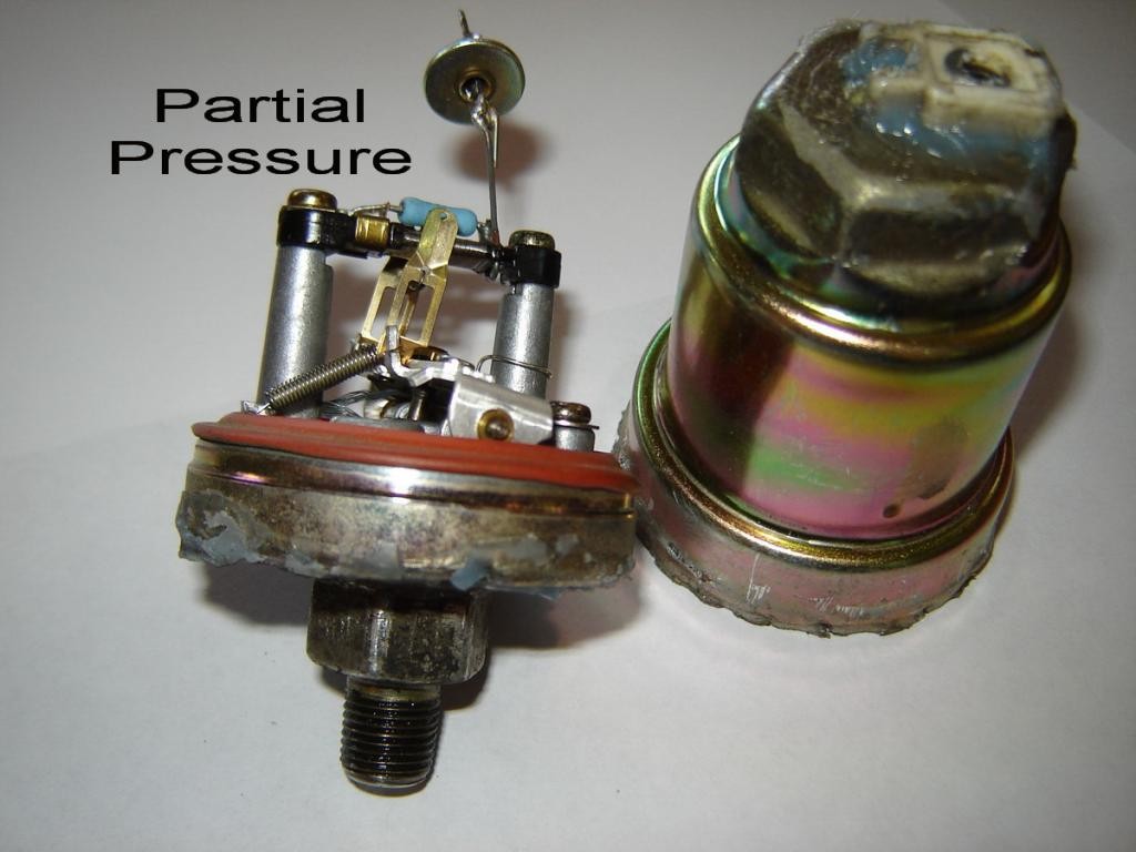

Then you have a look whats inside a 89-94 sender unit:
Its mechanical, and sits in an area where its heated, covered in oil, has poor sealing (silicone?). After nearly 30 years, its probably not a surprise if a spring weakens, or a linkage stiffens.
