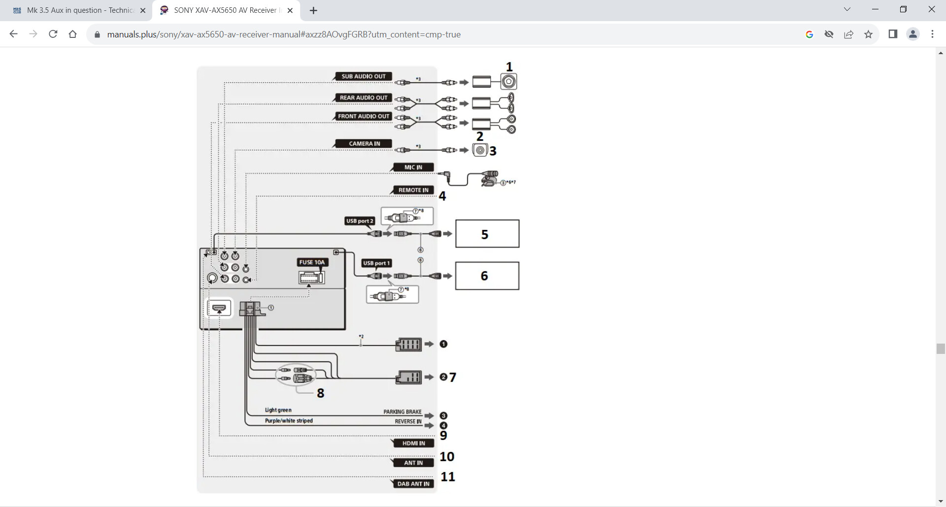

This page from the manual shows that the dab aerial is connected directly in the back of the head unit so yes - the unit will need to come out to swap aerials.
Thanks Dean, Thought so. Might buy a small dab aerial extension lead and fit that. I can then play with different aerials. Regards Glenn
