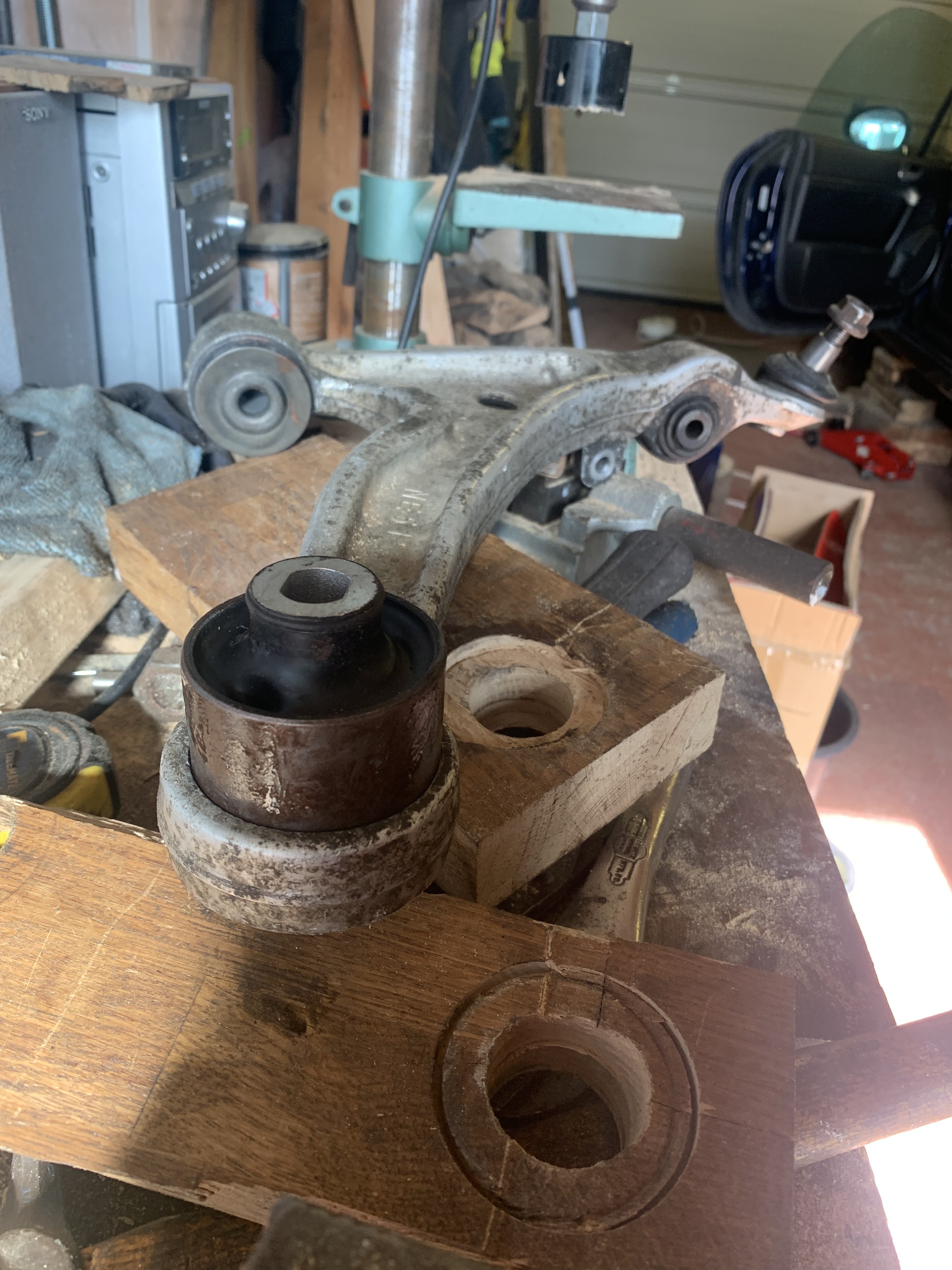

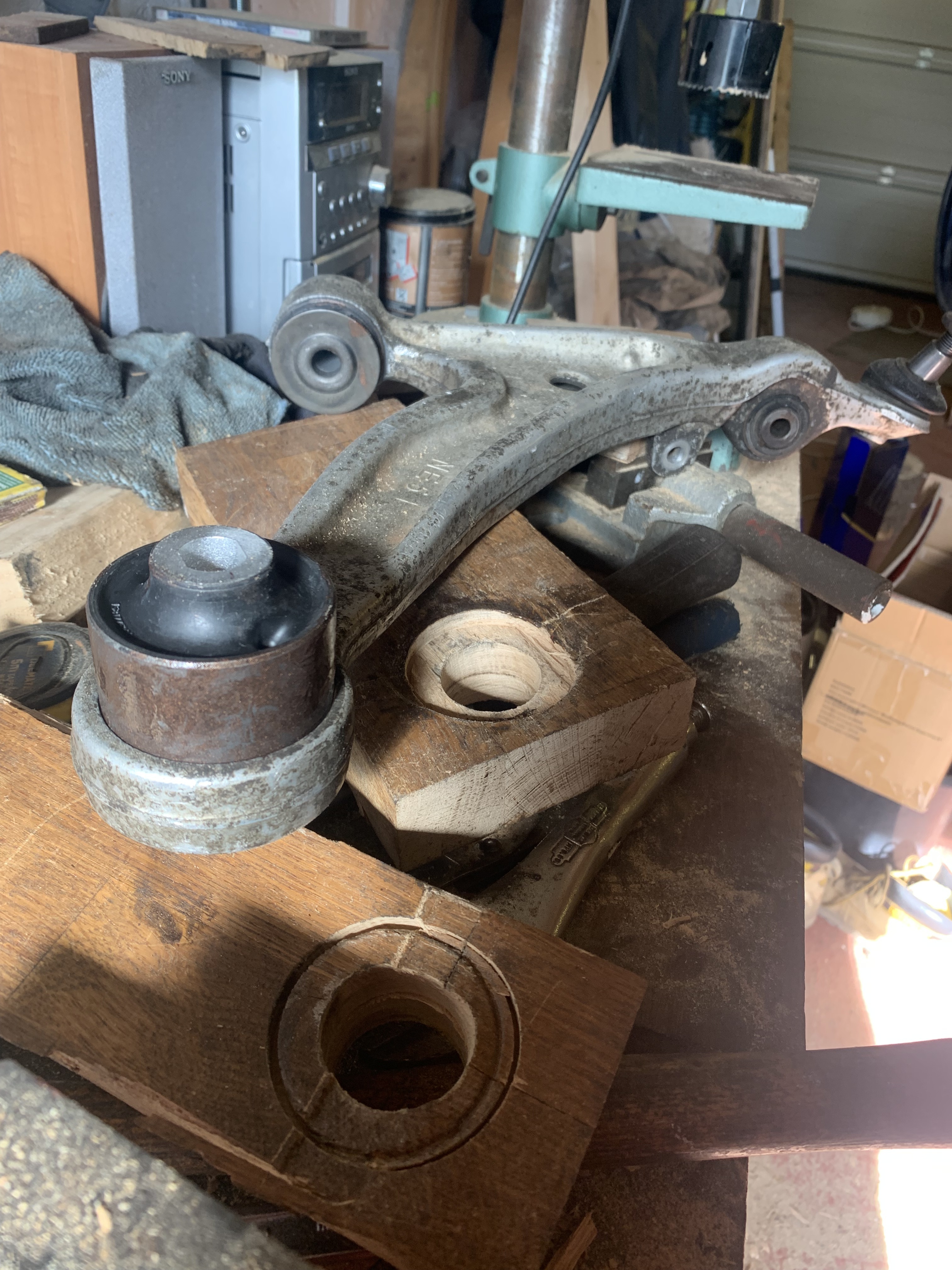

I am looking for technical advice on fitting the front lower arm rear suspension bush orientation. I had to saw the old bushes out so have no reference point on fitting the new bushes. The bushes have different protrusions from the main body. I have attached two photos on the alternatives. Thanks for looking John
Looking at this listing - it would suggest that the bush sticks out more at the top
Thanks for the reply yes it look like it is opposite to the ball joint stud. I had looked at some other listings for new lower arm with bushes but couldn’t be certain which way round they are. I am now going to assume both sides will be the same i.e opposite to the ball joint stud.

Most of the time I would centre the bush in the arm housing to allow the best range of movement in the rubber. But I don’t have a specific guide on this bush.
Just looked through my photos.
It looks like the “460” moulded in the rubber goes to the top of the arm.
Thanks for the info Richard I had started to insert one of these bushes and had approximated the alignment from the old bush which I took a picture of nice to get the correct info. Guess what 50/50 chance that I got it the right way, this job has been a nightmare every nut and bolt. I got the wrong 50.
