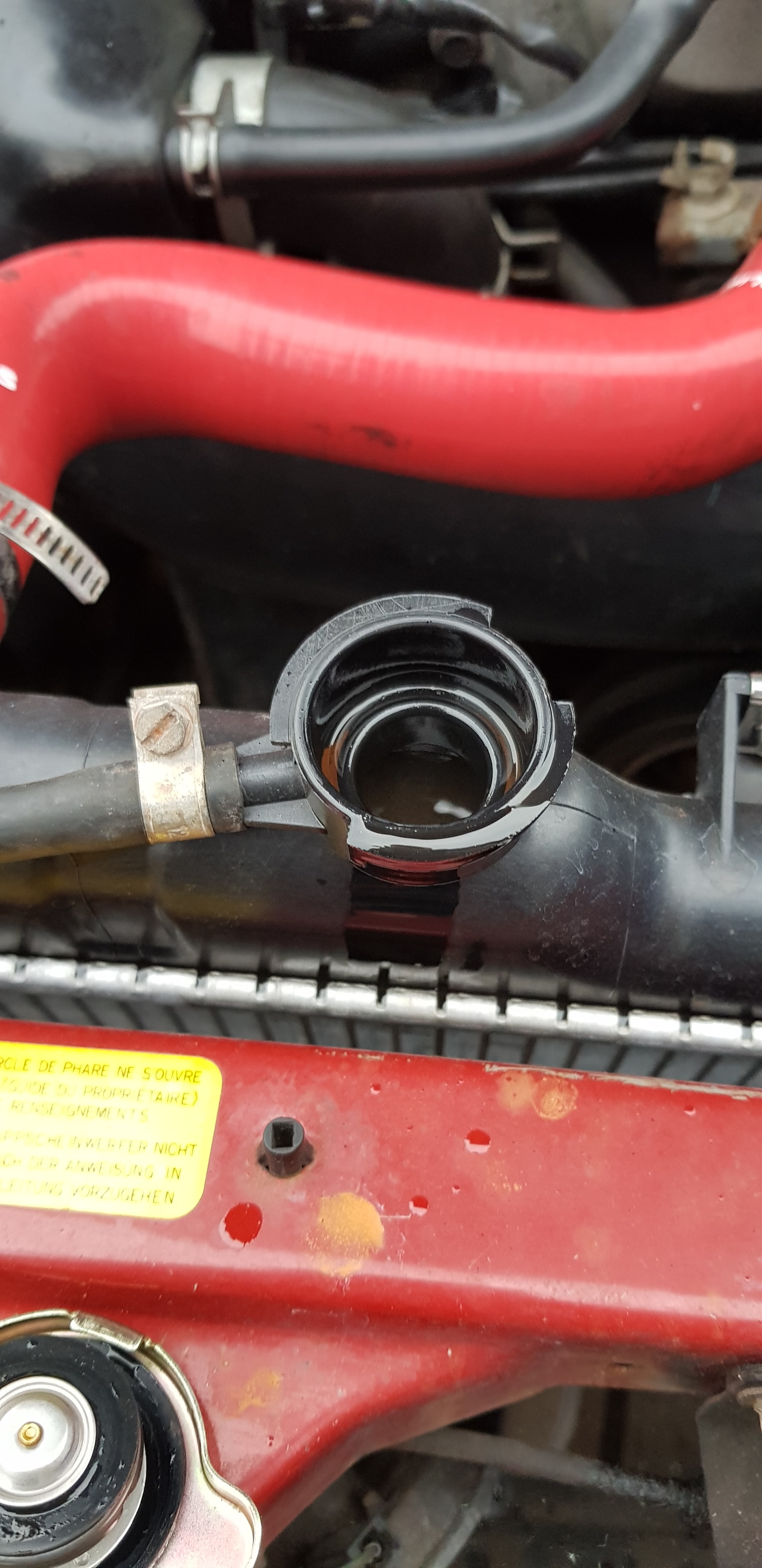

Is there another way to see if the thermostat is stuck? I just did the test where I took the rad cap off, turned on the engine a left for a while. It looked like this…
After a while and with a bit of revs the fan kicked in and the water started flowing…
This to me says the thermostat is kicking in?? It then went back to normal after. But still no heat out the fans. Pipes going into the cabin were both red hot.

The simplest way to check if the thermostat is closing normally is to run the engine from cold and see if the top radiator hose and radiator top tank stay almost cold until the temperature gauge reaches the normal zone. A working thermostat should stay closed until the coolant reaches mid-80’s celsius. Only when it opens should the top hose and rad abruptly get hot.
If the pipes going to and from the cabin got very hot then its likely the problem is elsewhere. It’s possible the diverter flap that guides air through the heater rather than around it is not moving properly.
