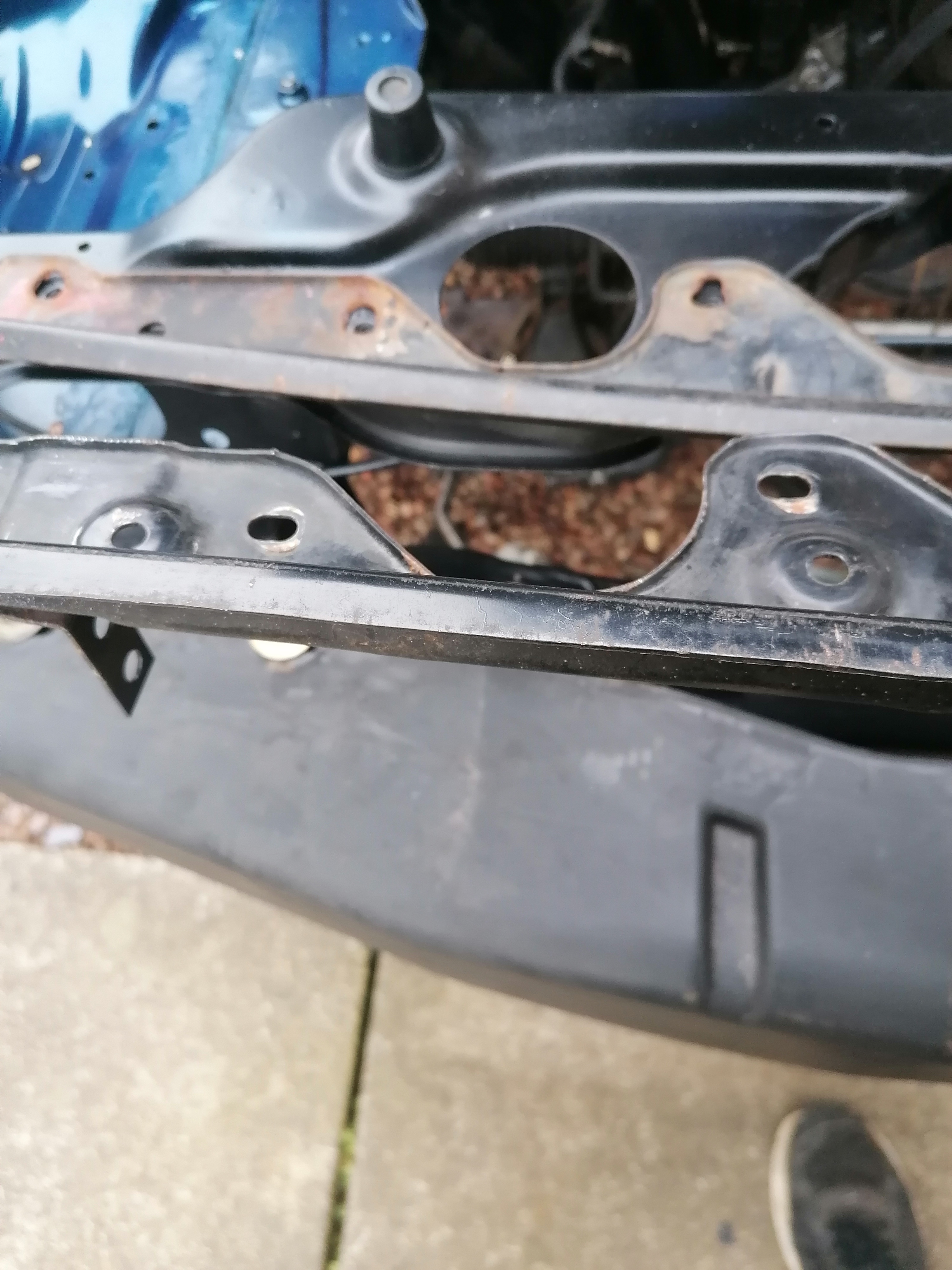

The upper front mounting for the front bumper (connects to upper landing panel) is different from what I took of my damaged car. I bought a used bumper complete with that mounting attached but while it fits there are differences in the shape, also my original unit has two angle brackets underneath as original fitment. My original has some raised areas not found on the used replacement, what are these for?
Can anyone tell me what these brackets are for as I never thought to take photos when I stripped it.
The replacement is on the car, the original is the foreground

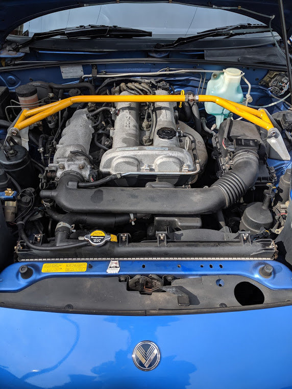

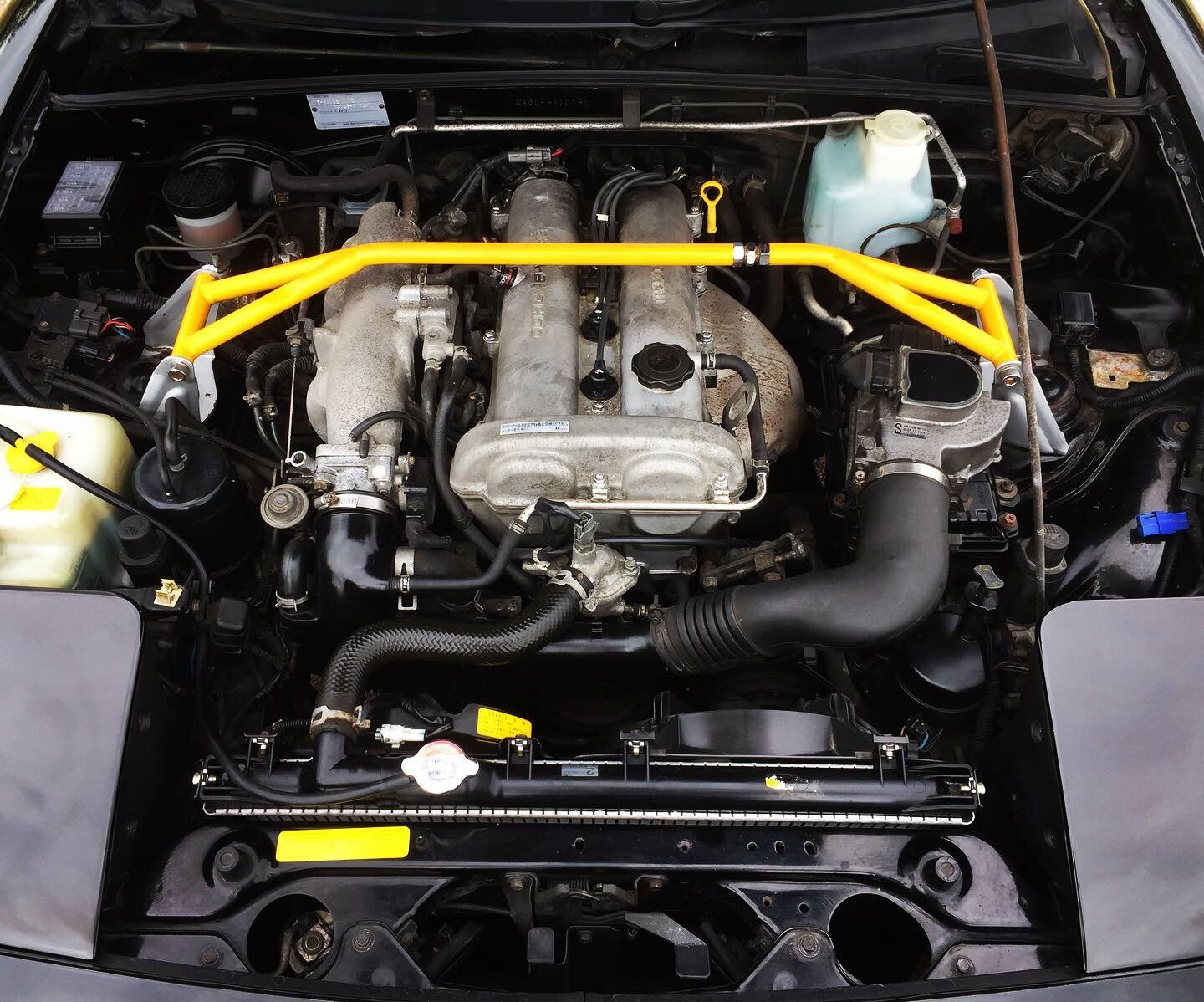

I’m guess its because the 1995 should have a plastic shroud that covers the slam panel, bu pre-1993 1.6 models never had this.
1.6 Engine bay
Later 1.8 with the cover in place
On a 1.8, if this cover ( called front bumper top seal, about £10 from Mazda) is missing, its a strong indicator that the bumper has been off before.
Without the pressings, fitting the cover to the early part you have doesn’t look right, it becomes all wobbly.

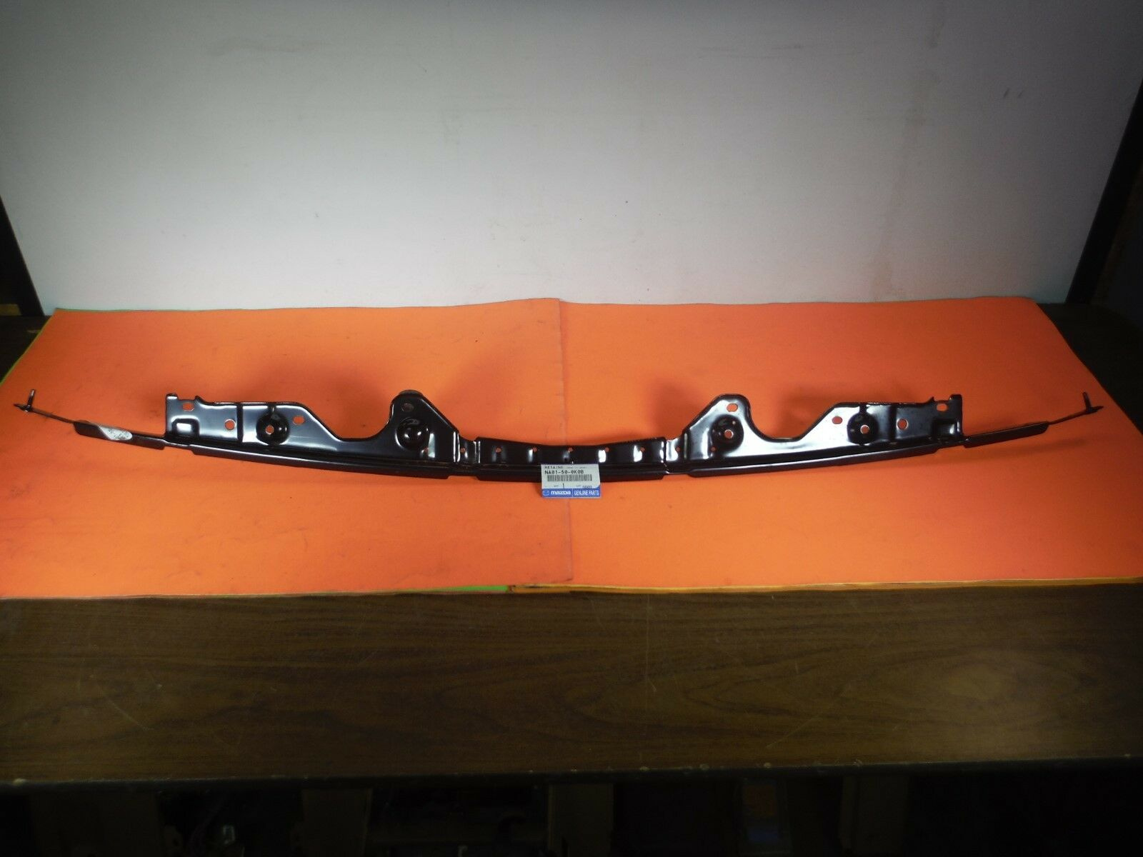

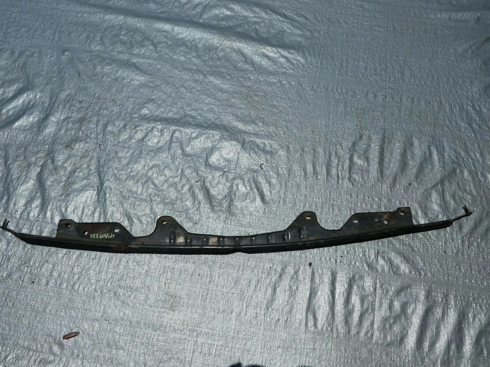

Early part
Revised part

you really know these cars:) I have the later revised part as original but it is a bit mangled so having to use the earlier 1.6, I should be able to fit the plastic cover somehow.
If the new part was cheaper I would buy it.
Still not sure what the brackets on the revised part do, should become clear as I assemble.
