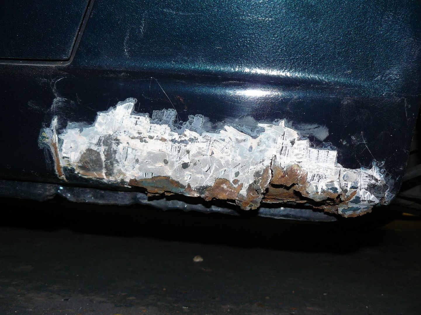

While bleeding the rear brakes I decided to check around the sills with an inspection lamp. I had injected the sills a couple of years ago with Dinitrol and removed some light bubbling to the sills and zinc primed them and sprayed with stone chip guard. Upon inspection, I notice some bubbling again so decided to take the paint back to take a closer look. See below, I made the hole having a really good poke around, well I say hole, but it has not gone all the way through and is pretty solid underneath, although rusty. I also noticed some rust at the inside bottom of the wheel arch. The rest of the car is solid.
Can this be patched up again and then go for a sill replacement in a couple of years, or is it better to just get it done now? It does’nt seem that bad to me, I’ve seen allot worse, but I guess it is what lies beneath! Expert opinion appreciated before I decide what to do. Thanks.
Paint removed.
The hole, not completely holed yet!!
That hole is all the way through the outer wing. What you can see is the sill strengthening member. As it stands, thats an MOT failure. Where its gone is just the tip of the iceberg. To get to solid metal will need a lot more cut out. its rusting from the inside out in multiple places.

I had a similar sized hole on my 1996 Roadster, which I had arranged to be repaired while the car was being repainted. The repair used was a patch over the hole, as I found out. 18 months or so later, it looked a mess. The patch might have made things worse.
You can just about see the patch. Not sure if the patch accelerated the rot, because it created a moisture trap, or really, that little hole was just a harbinger of doom, and the whole lot needed to be chopped out. Certainly the delay mean more repairs to the wing lip; if it had been done properly 18 months earlier, possibly the original lip could have been retained.
