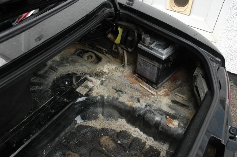

At that price circa £70 you will probably not get a battery with vent fittings on it. Therefore there is a reasonable risk that if you do not use the vent hoses in the boot to get the slightly acidic gasses that a battery can produce (and no battery is gas sealed) out the boot it has caused corrossion in the past on many cars. There are others on this forum who will advise they have never had the problem with a noraml battery. So no vents on the battery no connection to the vent hoses.
The boot is not airtight but has no through draft like in the engine compartmentso no natural venting for these gases.

I was very clear re corrosion some people say there is no problem and I said that on line 2 of my reply, others disagree and have posted pictures. I think I covered both camps there, see the picture at the bottom of this reply.
