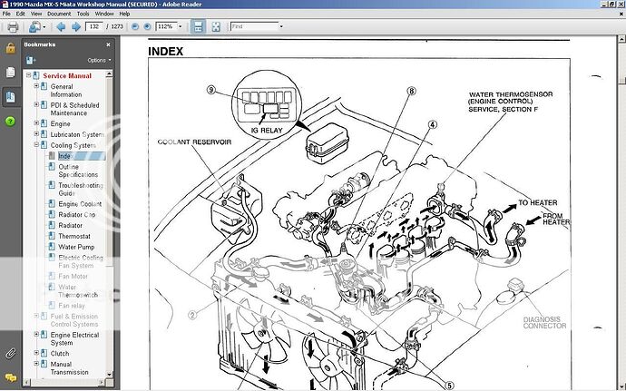

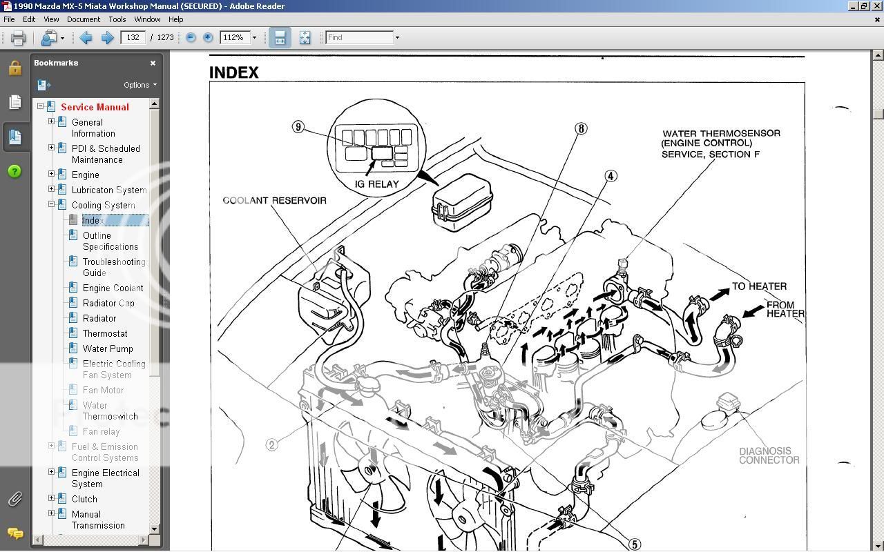

Here’s an extract from the workshop manual. The temp sensor is to the right hand side of the pic
Geoff - thanks for the picture, so it is right at the back, by the looks of things if i follow the hose from the heater back to the engine i should find it :P
From what i remember from looking under the bonnet - thats not easy to get to?! lol, ill have a look on my day off though :slight_smile:
