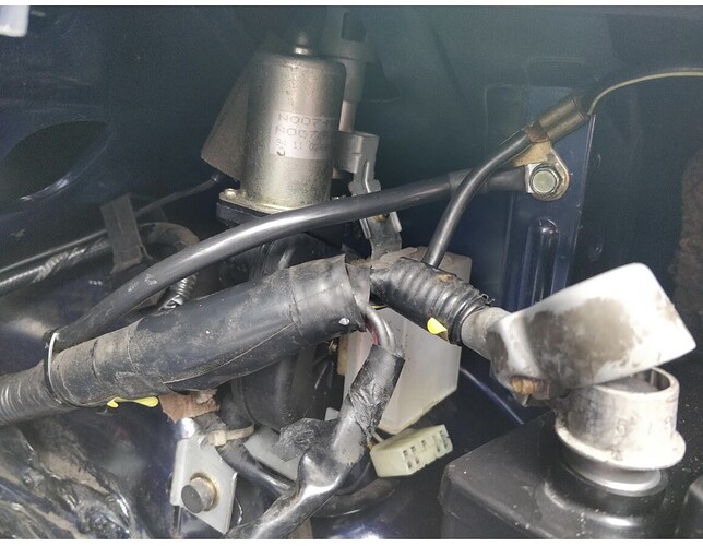

So it’s the part of the cable off the battery end which is a bit confusing (see pic). I can see there is the cable from the battery terminal, then there is a junction where it bolts to the mount next to the battery, then the cable continues to the PPF.
This guy has replaced the cable with new (cable directly under the nut), but it appears he has the old cable running down to the PPF still in place. Of by doing this, and cutting the old cable that runs to the PPF and replacing that section with new, is this correct?
There’s no harm in running another cable in parallel with the existing one. You can leave the existing in place if you like.
Yup, otherwise you are unpicking 30 year old insulation for no gain.
