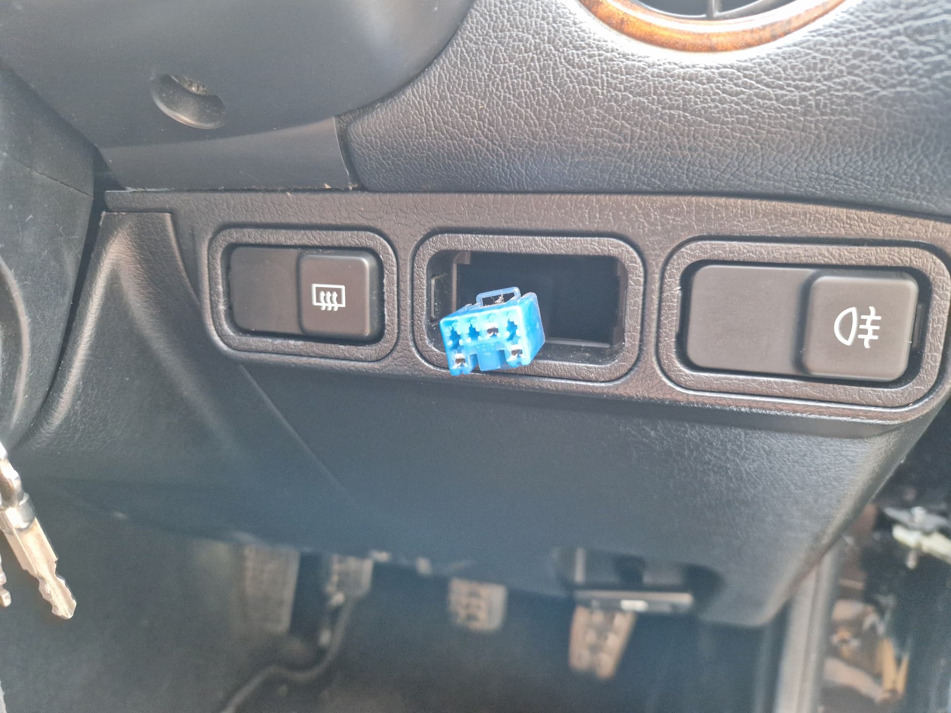

Popping off one of the switch blanks I found what looks like a pre-wired live connector. Can anyone confirm what this might be for?
My model of MX-5 is: MK1
I’m based near: Chichester
Looks like the instrument cluster dimmer plug to me. Does whatever you unplugged from it have metal connectors on the back?
Yep, it had a metal strip inside it. I’ll grab a photo tomorrow.

That’s for the dimmer. With the blank left unplugged, you’ll have no dashlights. The dimmer was an option in some markets.
Ah this makes sense. I thought it looked too OEM to be a previous owners work to blank something off.
I guess I need to find somewhere else to install the switch then or remove my rear window heater switch (I never use it).
There is a duel HRW/Front fog switch available if you can find one.

Classic97:
You make a jumper cable. Or you move a few switches to the spot under the radio. The foglight switch by your right knee is in a truely terrible spot anyhow.
