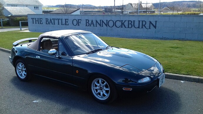

I miss mine more each day! This had about 5k on rot done alone…worth every cent to me.
