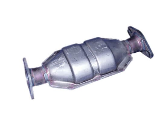

440mm cat:

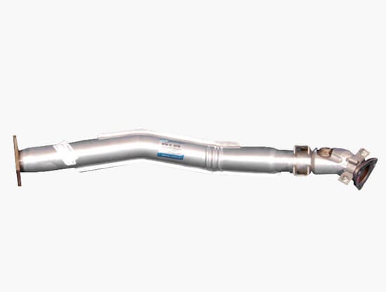

Front pipe:

This option is available but not everyone wants to spend £160 + delivery on a front pipe where much cheaper alternatives are available.

I worked with the UK manufacturer to develop the front pipe when one of my customers had a problem fitting our existing part for the longer 475mm cat to his 435mm cat. It was only around two, maybe three years ago we found out that the front pipe for the longer 475mm cat is not suitable for the 435mm cat. They needed an original part which they keep. A bespoke Jig is made for the part and caliberation is checked with the original part between batch manufactures.

I’d like to see what a 575mm cat looks like. I know 370mm (375), 440 (435), 475mm, but not 575.

It is 475mm, I misquoted the measurement…but you already knew that. Will edit post above to avoid confusion and reprogram brain. I actually spent time looking for a picture of an original one to post before the penny dropped.
