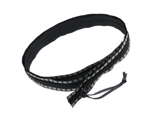

If need be you can get a new zip fitted if yours is original then this is the part:

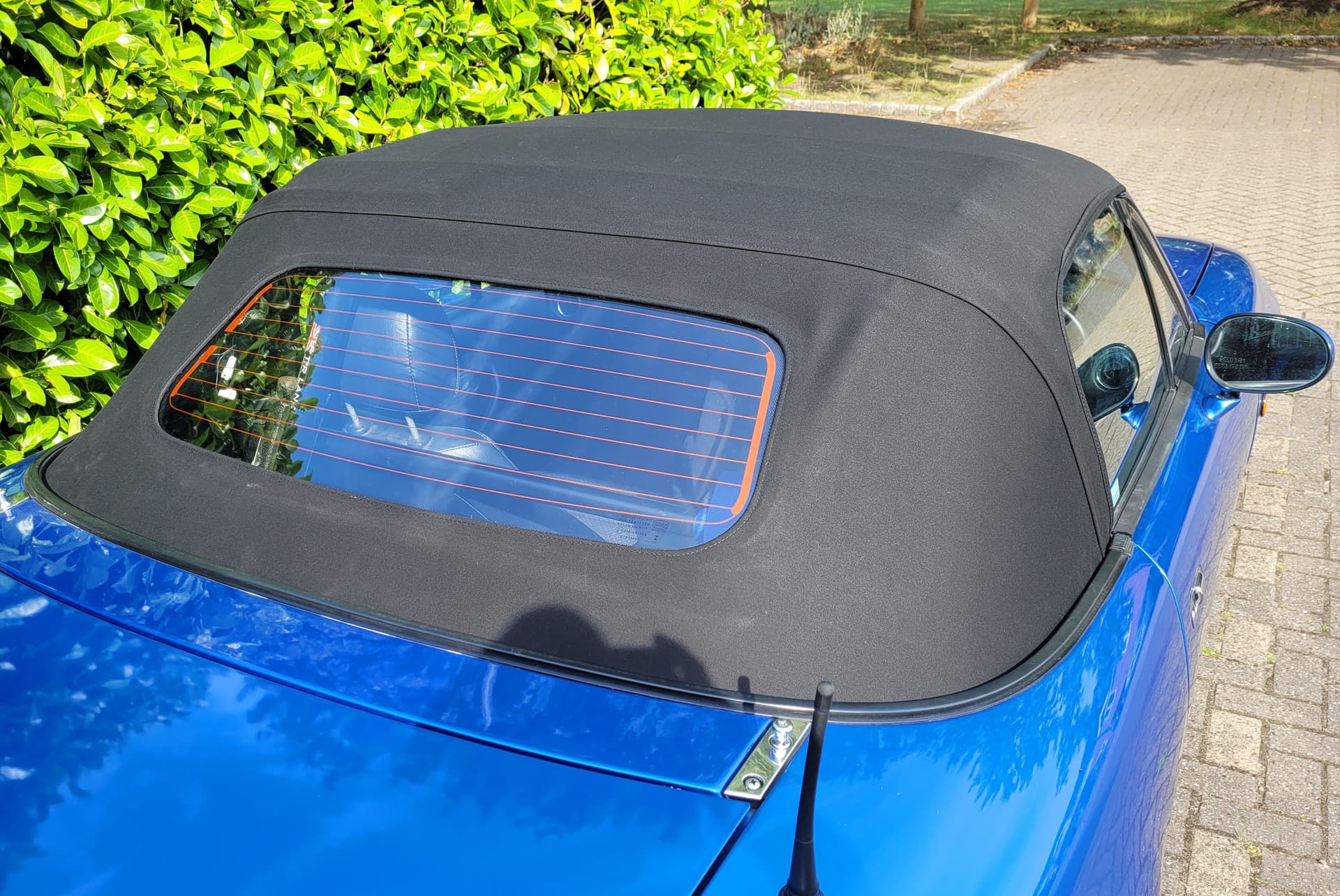

A good opportunity for a new roof with a glass rear window. Hothoods did a very nice job on my Mk1 with what they call a Mk3-style roof, which lacks the two thick fore-and-aft seams.

My Hothoods ‘Mk3-style’ hood uses the Mk1 frame with a couple of minor mods, which the Hothoods fitter carries out. It all works fine. The glass window is permanently attached to the hood and folds away with it. Open the hood part way, push window down, continue opening until fully down. Having a glass, and heated, rear window is brilliant in winter.
