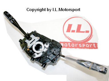

Right, a bit more info. Discovered there are 2 versions on the NA. My '91 Euno has straight stalks, a '96 UK MX5 has stalks that come out higher up and then have a bend.  A Google on German Ebay (Ebay.de) for miata kombischalter or specifically mx5 na kombischalter brings up a few that look identical to the '96 UK model EXCEPT the indicators are on the left - that looks very encouraging, it may even plug straight in. Of course as well as Germany getting one from Ebay France or somewhere else in Europe might be an option if anyone knows the right words !

Later models with the cranked stalks has a spacer on the steering column and different shroud. Later models also used a different wiper motor, and the control of intermittant wipe was somewhat different.
Very early Canadian cars had straight stalks (no airbag), and reversed controls. The same would be true of 1990-1995 continental cars, but they are relatively rare.

On my UK car, the airbag and indicator plugs are only taped together, they are very separate. Horn and airbag on one connector, the rest on the other two.
If the US spec cars are the same, it shouldn’t be too hard to swap it over to a UK spec plug.

Anyway, I’m going to try and find a MK1 assembly in Europe and have a play, It could always be reversed back for the next owner. I think it would be nice at the same time to fix the problem of the lights not lifting when you pull the stalk - they do in a '97 UK spec Mk1 MX5.

As for Euro parts
Late type indicators, note airbag clockspring
http://mx5centre.com/Webshop_gebruikt/MX-5NAOnderdelen/MX-5NAInstrumenten?product_id=463
Early type, albeit out of stock
http://mx5centre.com/Webshop_gebruikt/MX-5NAOnderdelen/MX-5NAInstrumenten?product_id=464
Another early stalk;
https://www.japoto.nl/en/part/Mazda/MX-5/Steering+column+stalk/396/178215
Brand new part:
If you do get a continental set of stalks you’ll need the matching plastic column cowling as well, the cutout for the wiper stalk is bigger.
Unless you want to take a Dremel or similar to the cowling you have.
