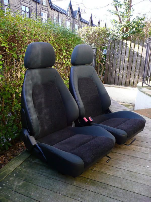

Seats from a UK mk2 MX5 will do the trick, like these below and as far as I’m aware should bolt straight in, although someone more learned will hopefully confirm or not:-
(these were mine but I’ve since switched to a pair leather mk2.5 seats which are non
adjustable headrests - and already sold on the mk2 ones) maybe someone on here can help with a pair if not eBay might be
your best bet.

My old seats, now happily residing in Essex IIRC…
 Would be great if the headrests were adjustable - I’m 6’2", and though I’ve just fitted new headrest speakers, unfortunately I don’t have ears in my lower neck!
 LOL Big Smile. I suppose the average Japanese test pilot must have been 5’4"

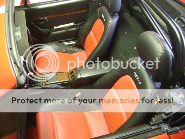

They look good, I have the later Mk1 seats with adjustable headrest and i’m 6’1" and I don’t have any trouble with height.
On another note, those seats look like they were recovered, if so do you remember where you had them done?

I got them off ebay out of a car that the chap was taking in on the scrappage scheme (it was mint, a real shame), I nearly had his hardtop at the same time but he wanted to let the ebay auction end Sad, I don’t know where exactly but a company around the South Midlands…I know that doesn’t help much does it?!
They were a re-upholster, rather than ‘covers’ and were lovely and comfy (new foam too) but were no use on track, hence they went to jgg who (as far as I know) was/is very happy with them.
