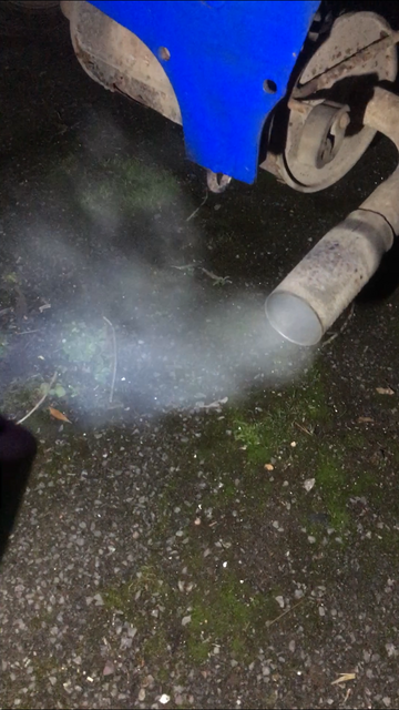

Mk1 white exhaust smoke
I have noticed that when I start my mk1 Eunos, there’s white smoke coming from exhuast, i have read up that can be head gasket going and/or Piston rings going.
Could this be other things, think engines running rich and know back box has gone/ maybe Cat. Could these be to blame?
i am planning on rebuilding engine at some time soon. But just trying to plan ahead with this, as had hoped not to delve into the pistons as know can be issues when replacing crank etc on a short nose

White smoke could be steam from a head gasket failure where  there is a breach between the coolant and inlet so coolant being expelled as steam in the combustion chamber(s) affected.
Given this I would expect the coolant level in the expansion bottle to drop and possibly some white creamy deposit inside the engine oil cap.

If the piston rings were gone, I would expect to see blue smoke and smell burnt oil as oil that bypasses rings gets burnt off in the combustion chamber(s)
Ifit only when you start up it’s just condensation in the exhaust. If used on short runs this is worst as it never gets chance to dry out
 This was on second start up, So Could be condensation as currently can’t drive on road, due to no MoT, Will roll with a headgasket change too as noticed coolant is brownish! This doesn’t contain oil of what I can tell, but prefer to prevent rather than cure any furture problems.

If the smoke in the photo is all there is, it looks to me just like condensation.

Yeah think is condensation,  Couldn’t smell anything abnormal.
If you can’t run it on the road then surely its just condensation from the heat up of the exhaust, normal.
However if it persists when the system is at normal operating temp then further investigation necessary.
