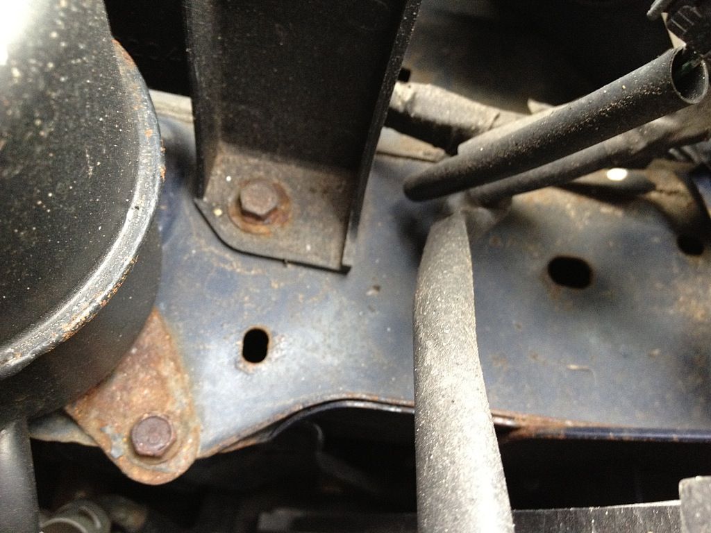

It is decidedly embarassing to post pictures of my engine room here, after MickAP has already posted his  Embarassed

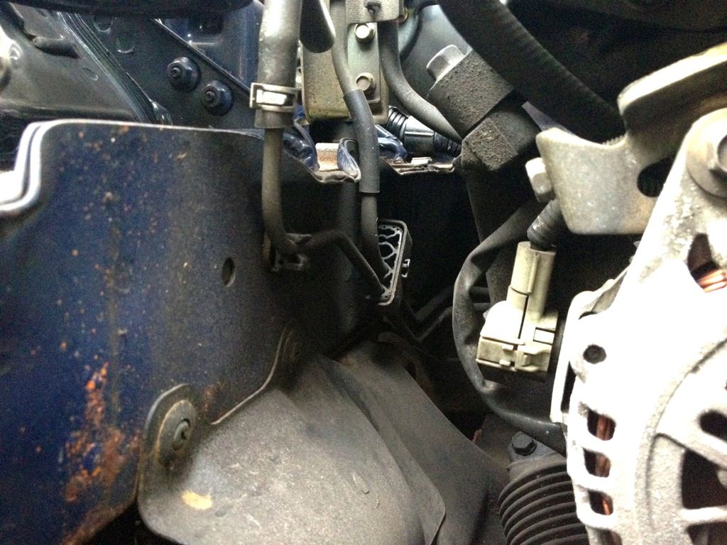

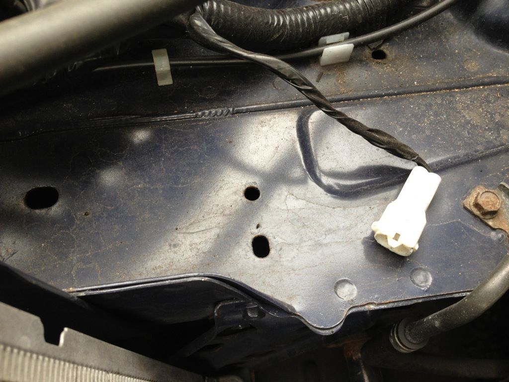

But if you can ignore some grime, here are the results from having a closer look on my rails, Only by lifiting the bonnet mind you…
Right side rail, top front
Right side rail, top front.
Left side rail, top front
Right side rail, middle from the side, towards the rear

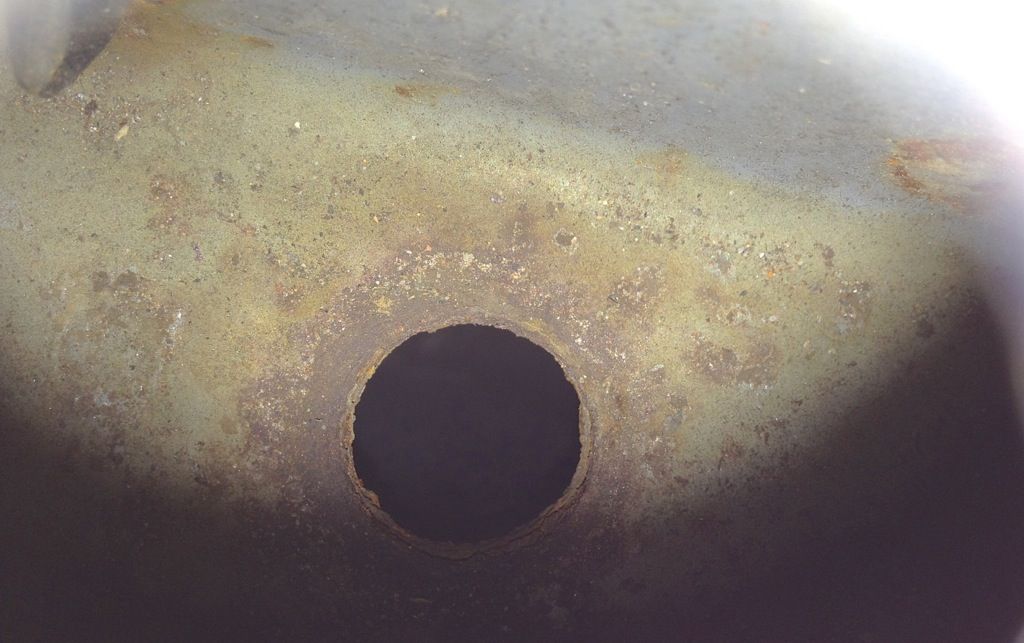

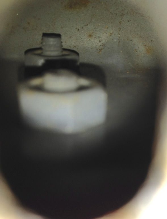

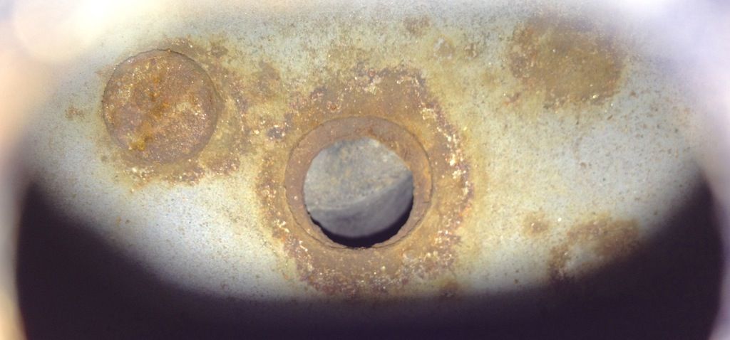

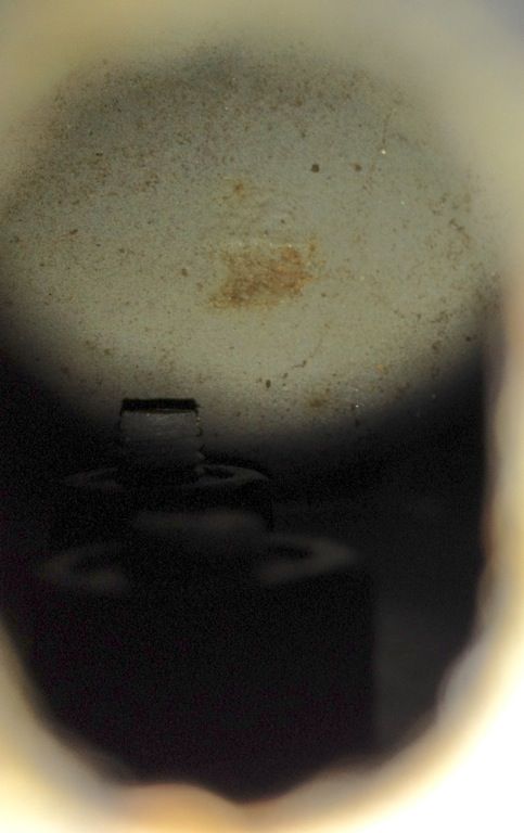

I also managed to poke the iPhone into some of the (airing?) holes on top of the right side rail (just to get an idea of the situation inside the rail):
Ok, not the prettiest pictures in the world but at least not unmitigated rust disasters either, or what do you think? It certainly seems like a visit to the nearest rust treatement centre could be prudent before the winter.
Doesn’t look that bad! makes mine look great tho ha ha!
Seriously, I would be taking an old screwdriver to some of that to see if its gone through and treat the rust before you take it for its treatment as a caution.
Have you or anybody come to that tell me what that white plug is for in your first picture please?
Secondary radiator fan. I have two fans and on that side, OS the white plug is connected to the fan.
