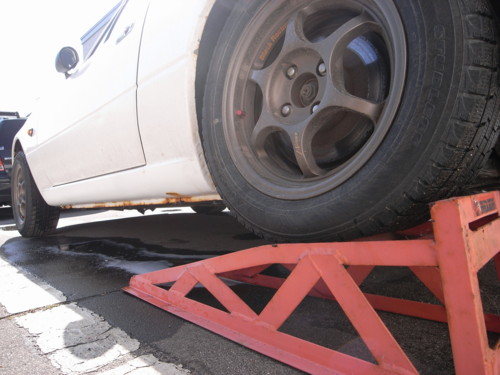

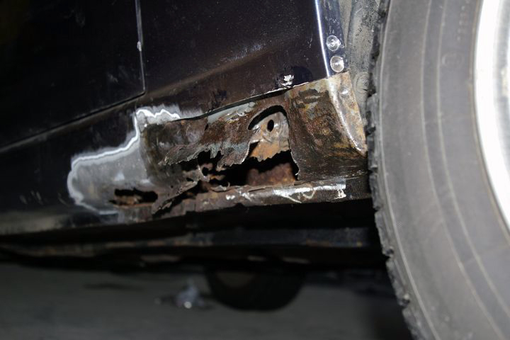

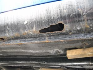

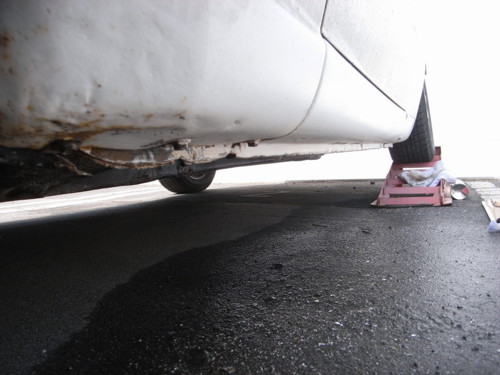

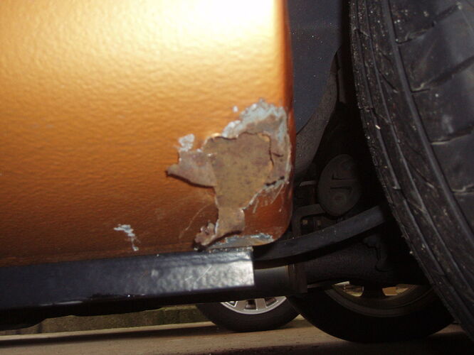

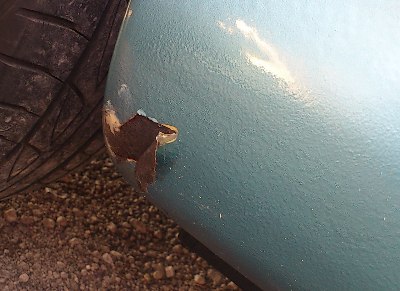

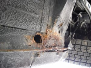

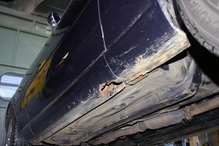

Be careful with such sweeping statements. These are all  photos of Roadsters undergoing rust repair in Japan. Note how clean the under carriage look
Bodged Japanese repair not holding up:
Spot of Mk2 rot, Japan style:

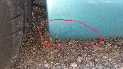

They’ve even got Mk2.5 rust now:

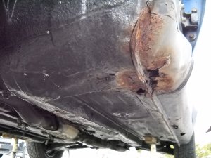

In fact, there is this buyers guide in Japan, that specifically warns about sill rust:
http://mrrs.jp/blog/archives/201105/11-063426.php
At one time, Roadsters were less rusty than UK cars. That was a while ago. Imports of good Mk1s more or less dried up in 2006, and the currency collapse in 2008 pretty much put paid to any more cheap imports from Japan. The majority of imports came in between 1998 and 2002 (you can work out the numbers on howmanyleft.co.uk). So most imports have been over here a good 10 years, or more. The rust free description is less applicable these days.
Depressing, huh? While most of the rot is in the usual places, some of it is a bit different from here, for instance the advanced front wing rust. I think this is rust from the outside in. Recently removed the wings on my car, and think I caught it in time.
