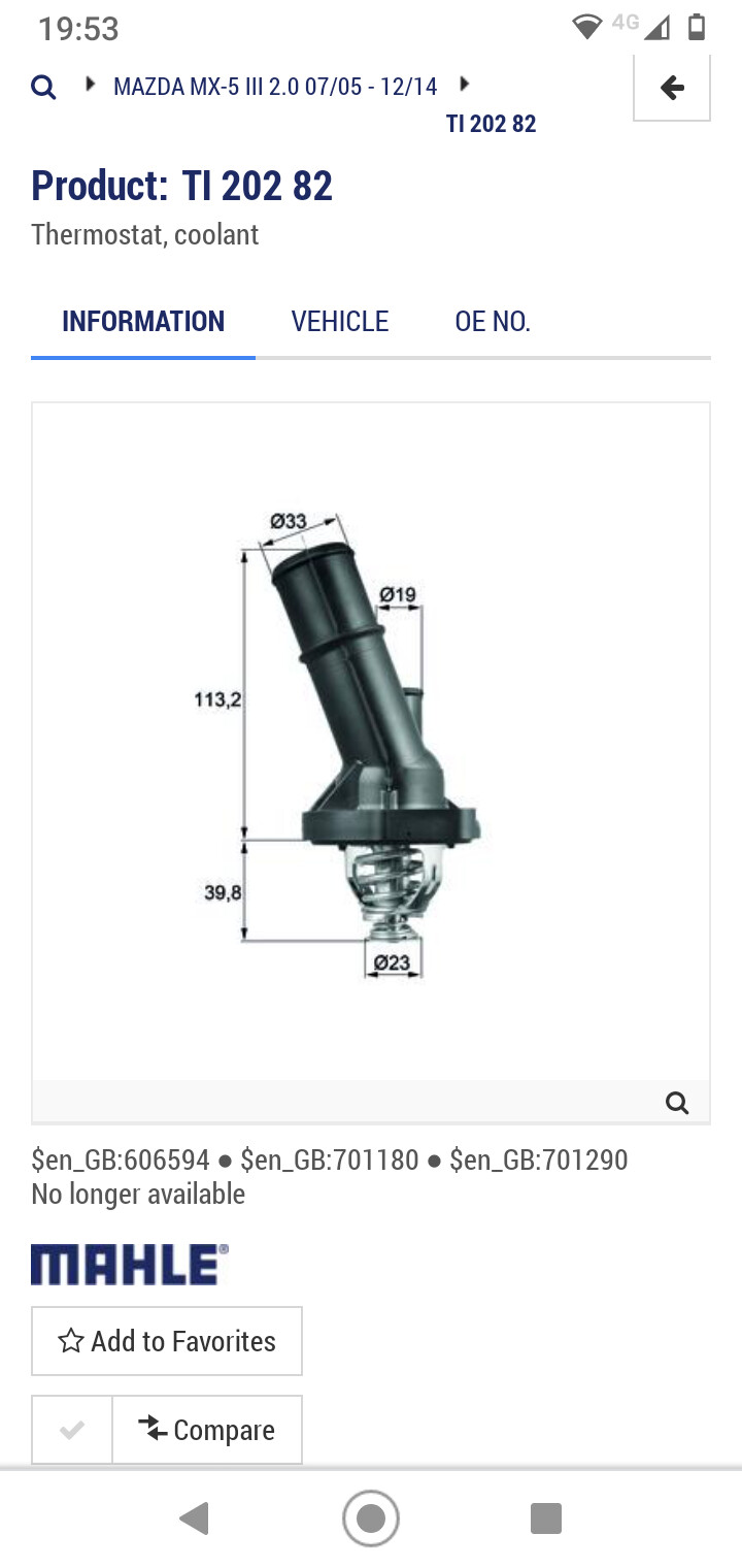

Mahle ti 202 82 if you can find one.

Whether your is the short or long nose version buy the one above, if the you have the shorter version fitter (original) then all you do is trim the hose by around 30mm and it fits.

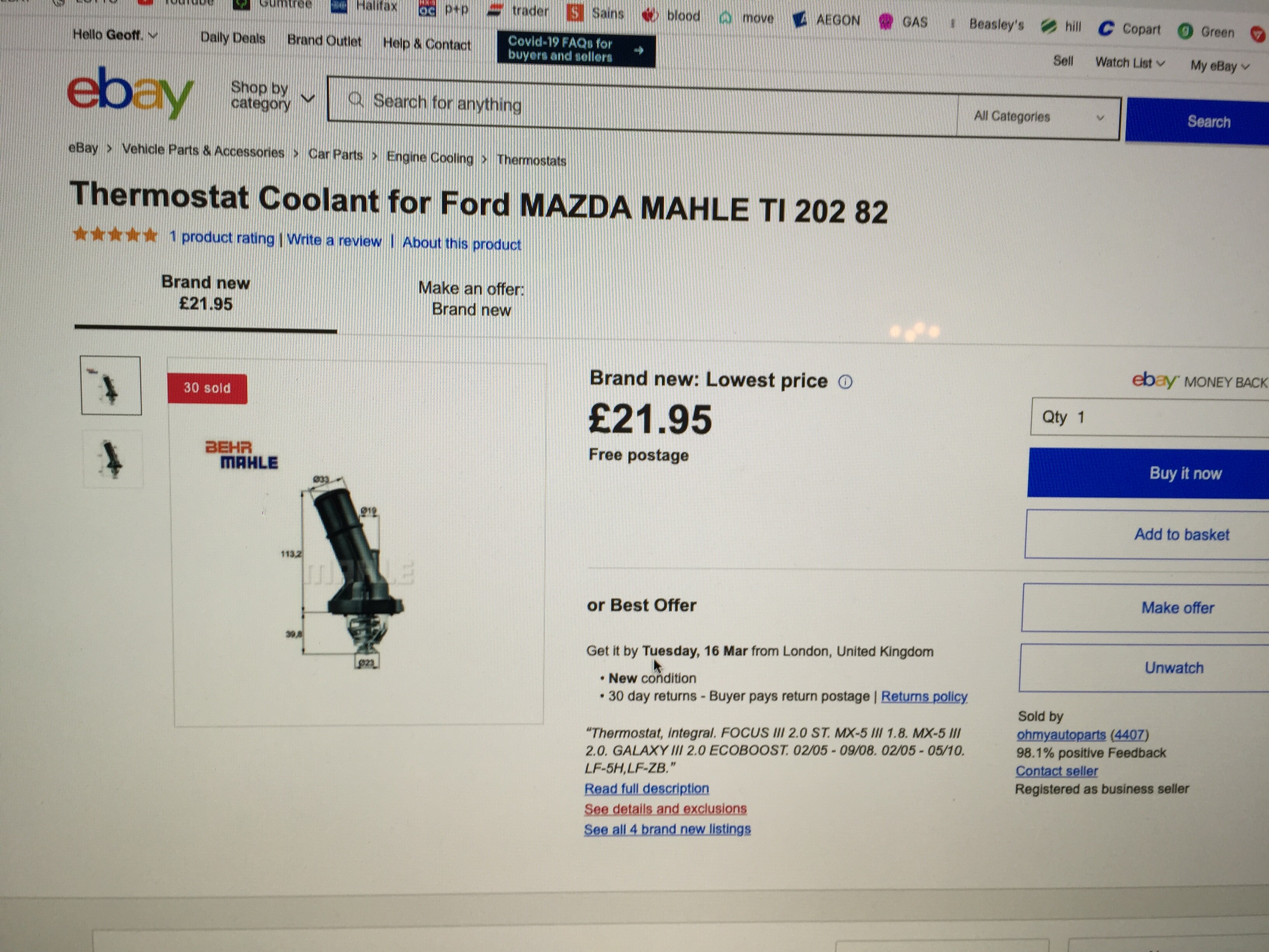

Just been contacted by seller on ebay that the thermostat is out of stock :grimacing: :grimacing:
any one know where might have one ??? , every where i checked is out of stock for immediate delivery :unamused:
Just had the same.
Hello, sorry to inform you but we will not be able to proceed your order as we have some issues due to Brexit ( we cant get some parts in time) and can not proceed the orders at the moment… We will make you a full refund now.
yep, same story here :astonished:

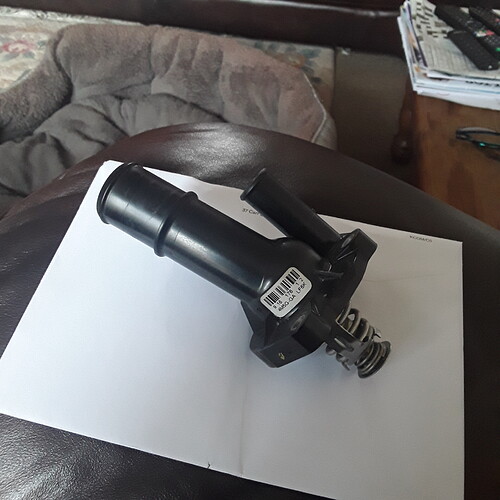

Is this what you require? I have one here been sitting on a shelf in my workshop since I got my nc1 2 years ago. I have no plans to use it so up for sale.
price please posted ?
Bally Mx5parts have the long neck version, it will fit your car. If you have the short neck version fitted just trim the large hose on the car by around 30mm, that what I did.:+1:
